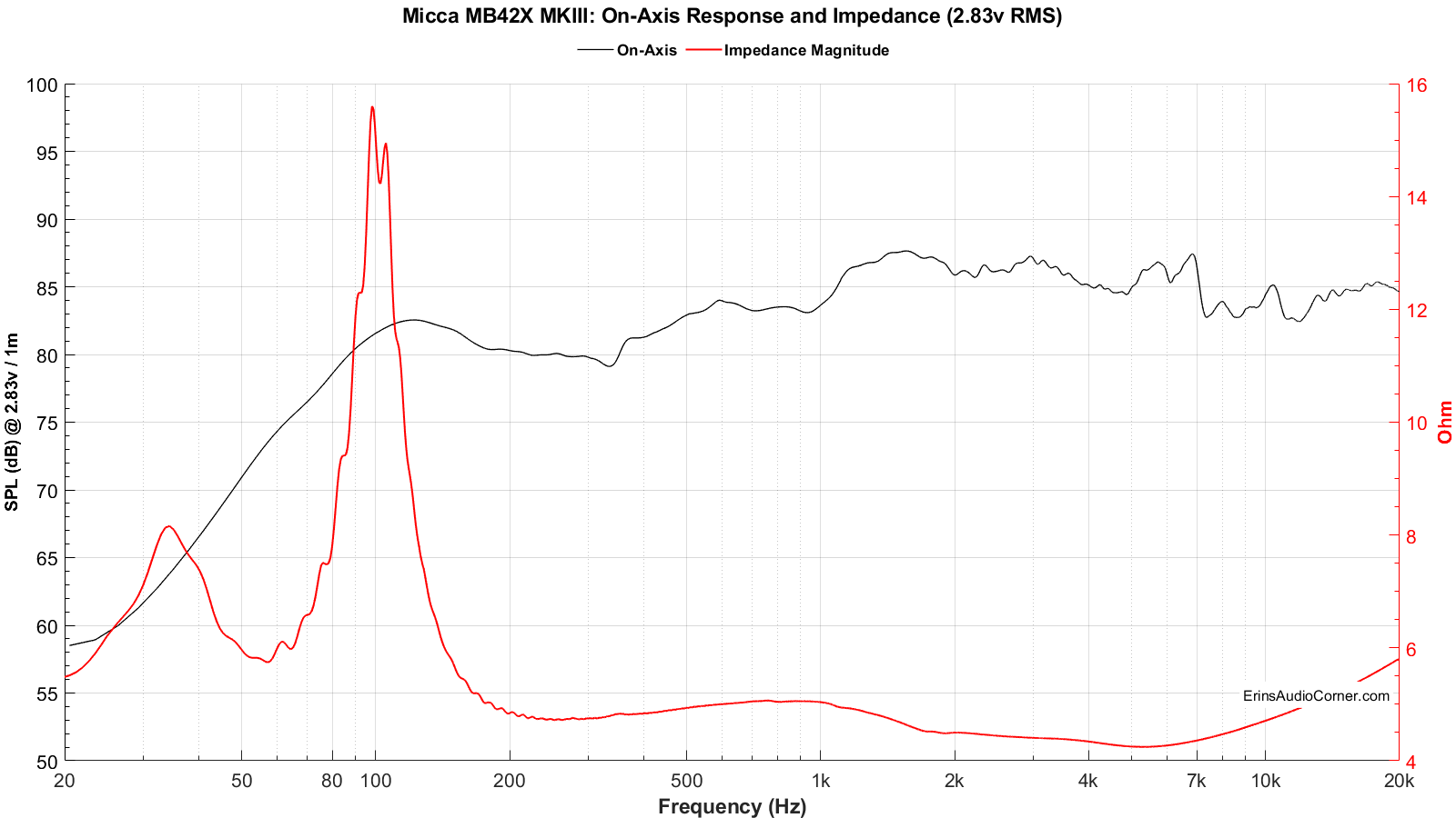

Impedance measurements are provided both at 0.10 volts RMS and 2.83 volts RMS. The low-level voltage version is standard because it ensures the speaker/driver is in linear operating range. The higher voltage is to see what happens when the output voltage is increased to the 2.83vRMS speaker sensitivity test.
From the above data we can see the following:

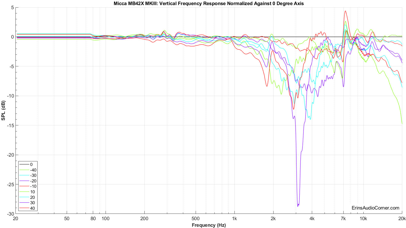

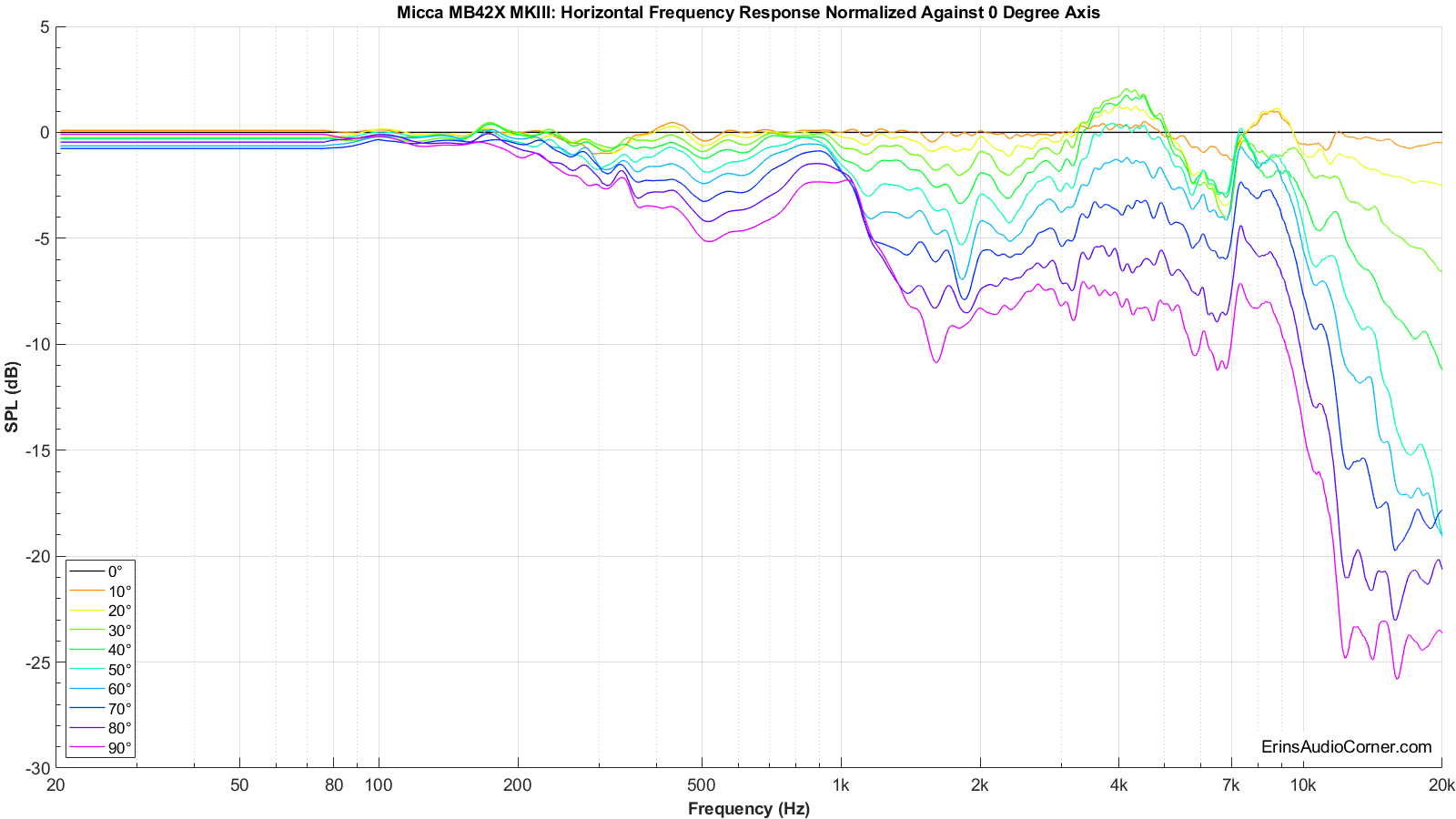

Below are both the horizontal and vertical response over a limited window (90° horizontal, ±40° vertical). I have provided a “normalized” set of data as well. The normalization simply means that I took the difference of the on-axis response and compared the other axes’ measurements to the on-axis response which gives the viewer a good idea of the speaker performance, relative to the on-axis response, as you move off-axis.
As I said above, the provided frequency response graphs were given with a limited set of data. I measured the response of the speaker’s vertical and horizontal axis in 10-degree steps over 360-degrees. Nearly 70 measurements in total are represented in my data. As you can imagine, providing all those data points in a single FR-type graphic below is a bit overwhelming and confusing for the viewer. A spectrogram is an alternate way to view this full set of data. This takes a 360-degree set of data and “collapses” it down to a rectangular representation of the various angles’ SPL. I have provided two sets of data: one set for horizontal and one for vertical. Each set consists of 2 graphics:

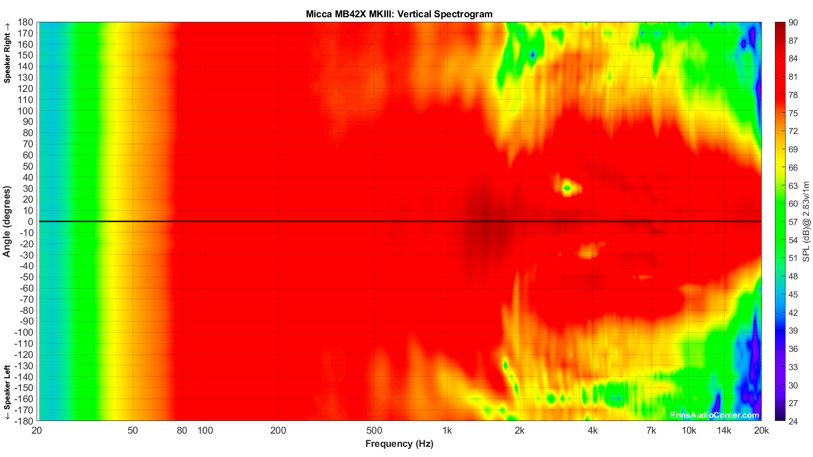

The above spectrograms are the standard way of providing directivity graphics by most reviewers. Some prefer not to normalize the data. Some prefer to normalize the data. Either way, it’s a useful visual to get an idea of the directivity characteristics of a speaker or driver.
However, these “collapsed” representations of the sound field are not very intuitively viewed. At least not to me. So, I came up with a different way to view the speaker’s horizontal and vertical sound field by providing it across a 360° range in a globe plot below. I have provided both an absolute SPL version as well as a normalized version of both the horizontal and vertical sound fields.
Note the legend provided in the top left of each image which helps you understand speaker orientation provided in my global plots below.

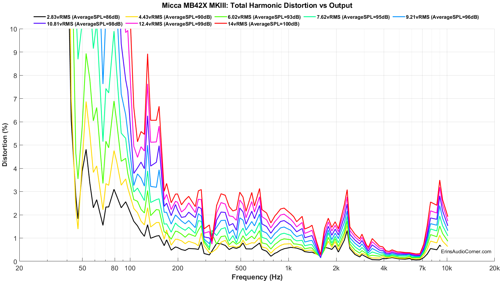

Distortion and Compression measurements were completed in the nearfield (approximately 0.3 meters). However, SPL provided is relative to 1 meter distance.
Harmonic Distortion and Compression: What does this data mean? (click me for info)

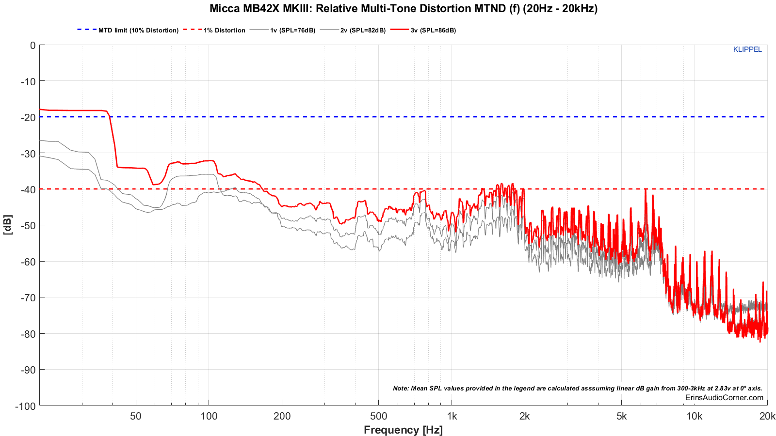

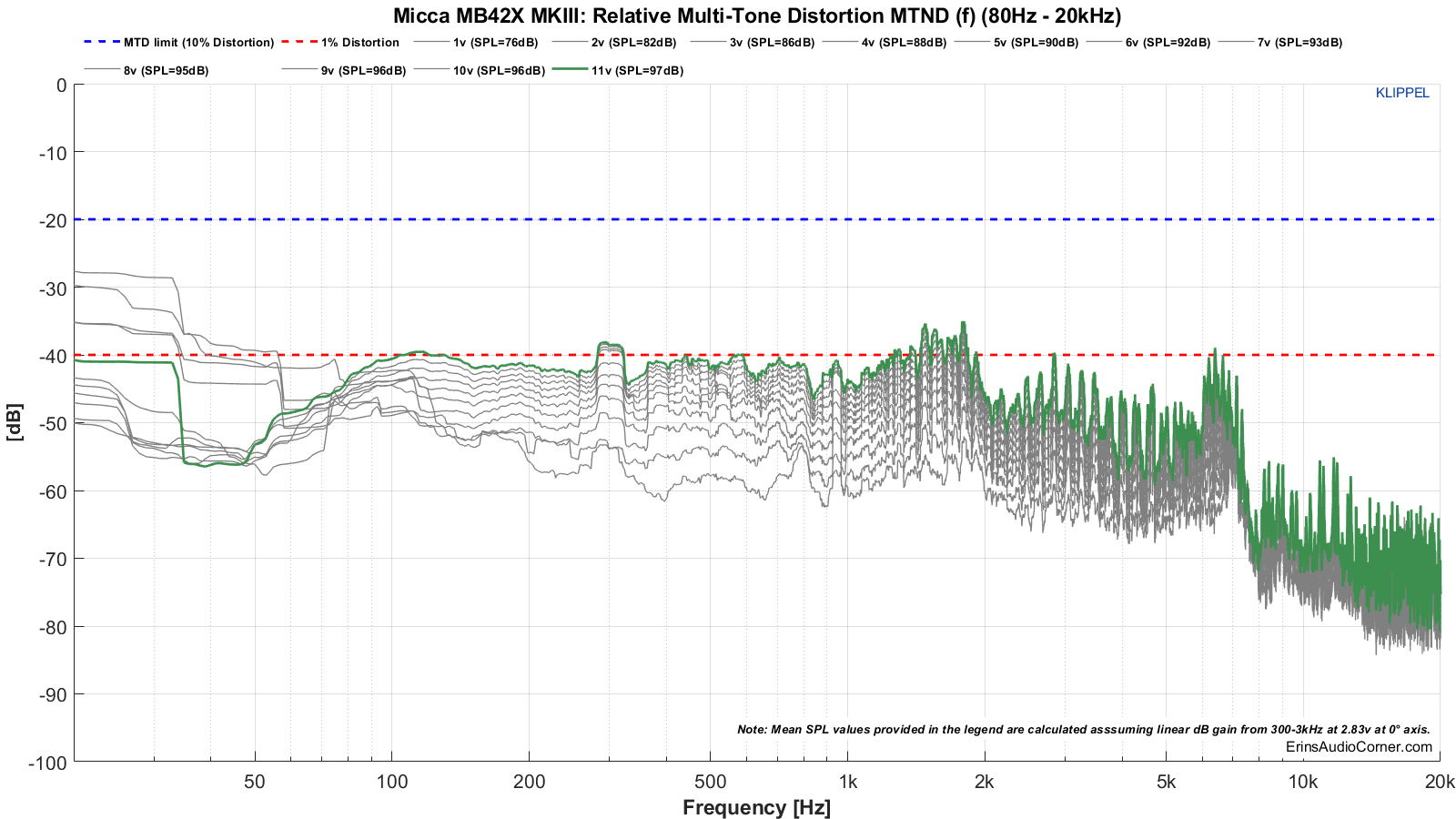

Test 1: 20Hz to 20kHz
Multitone compression testing. The red line shows the final measurement where either distortion and/or compression failed. The voltage just before this is used to help determine the maximum SPL.
Multitone distortion testing. The dashed blue line represents the -20dB (10% distortion) threshold for failure. The dashed red line is for reference and shows the 1% distortion mark (but has no bearing on pass/fail). The green line shows the final measurement where either distortion and/or compression failed. The voltage just before this is used to help determine the maximum SPL.

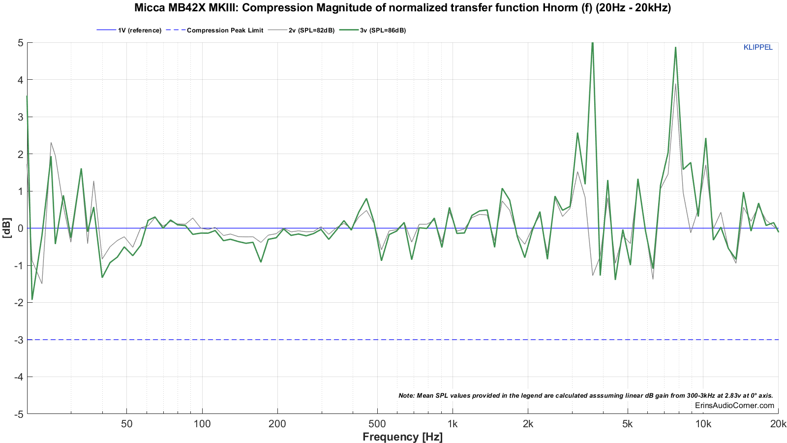

Test 2: 80Hz to 20kHz
The above data can be summed up by looking at the tables above but is provided here again:

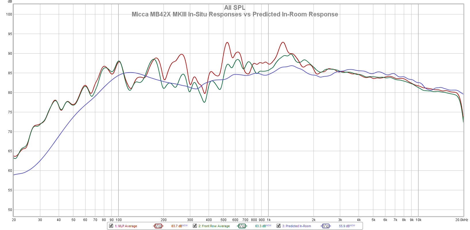

Let’s look at the measured in-room response I captured using my UMIK-1 and REW. Notice how well it matches the predicted in-room response.

Overall?…. YUCK. At this point I decided to move closer to see if listening in the nearfield would help (spoiler: it didn’t).
… and that’s it. I made it through about 7 songs before I just stopped. I couldn’t take listening to the speakers anymore. They were that bad.

It suffers extreme non-linearity and high distortion. While I think anyone in their right mind would know not to expect tons of output (not just bass; but overall volume) from a speaker this size, what you would expect is a semblance of linear frequency response. This speaker does not have that at all. The midrange exhibits a trough centered on ~300Hz. The difference in the midrange to upper-midrange/low-treble is nearly 5dB and then a 3dB dip from low-treble to upper-treble above 7kHz. This results in a very “hollow” sound in the midrange and rather “forward” sounding presence region followed by a lack of upper end detail and sense of space (also thanks to the increasing directivity of the tweeter).
As for bass… well, there’s really not much there. But, again, it’s a small bookshelf speaker with a 4-inch mid. There is a high-Q peak centered around 115Hz but that doesn’t do much except add some unnatural ‘umph’ to kickdrums via the harmonic. But, again, since this region is down so low relative to the treble region, it doesn’t really help.
Placing these speakers near a wall would help the midrange out but in doing so you just boost the overall response; meaning you also boost the trough in the midrange and the high-Q midbass bump. Plus, the rear port would be blocked killing the low end contribution it provides. Meaning that placing the speaker against a wall would be pointless.
Distortion is very high below 200Hz with greater than 5% THD at typical listening levels. Above this, the distortion is anywhere from 2-3% THD in the midrange at these same listening levels.

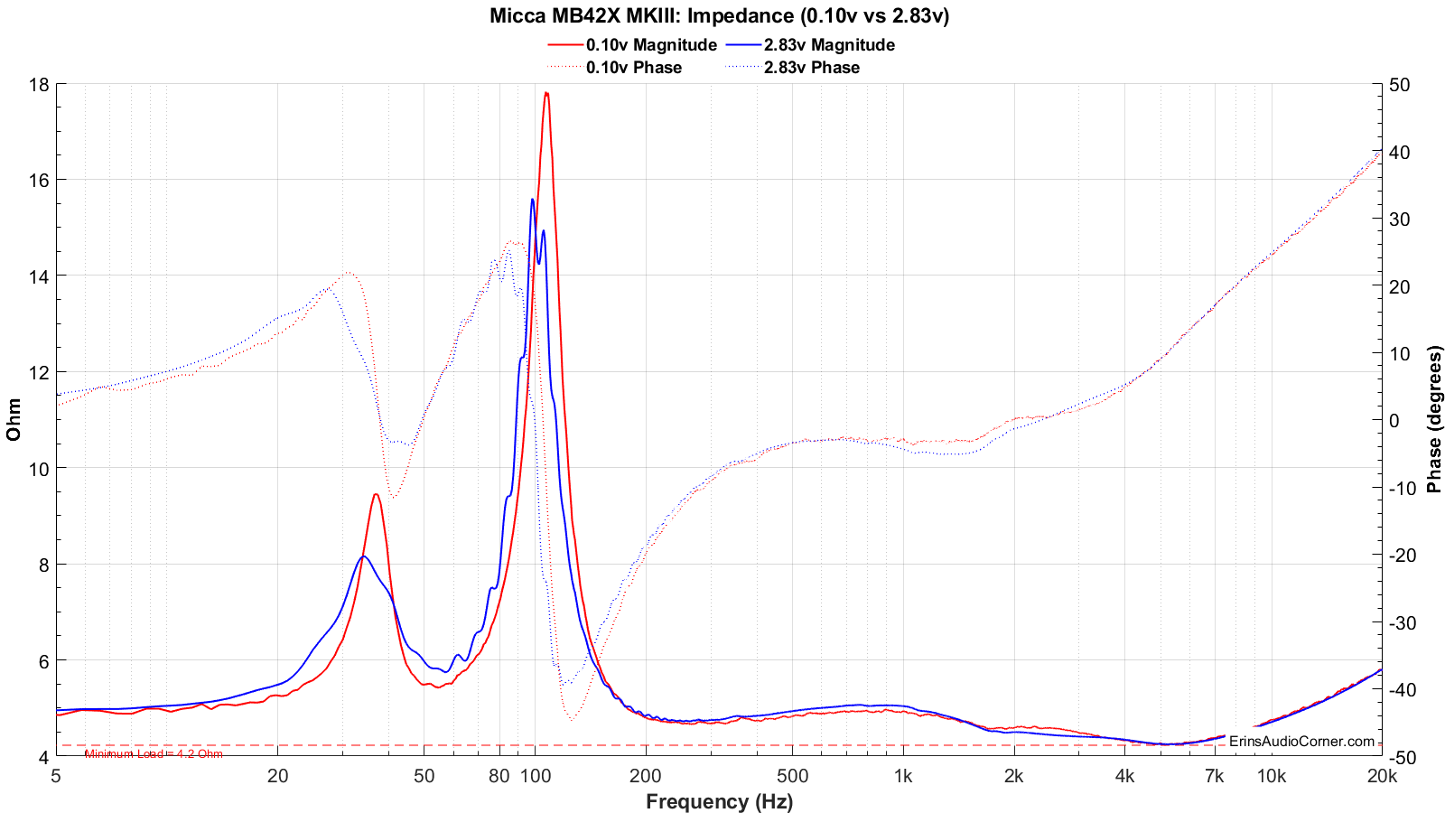

Impedance Phase and Magnitude:
- The tuning frequency of the enclosure is approximately 50Hz.
- The minimum impedance dips to about 4.2 Ohms around 1.4kHz with a nominal impedance at about 5 Ohms.

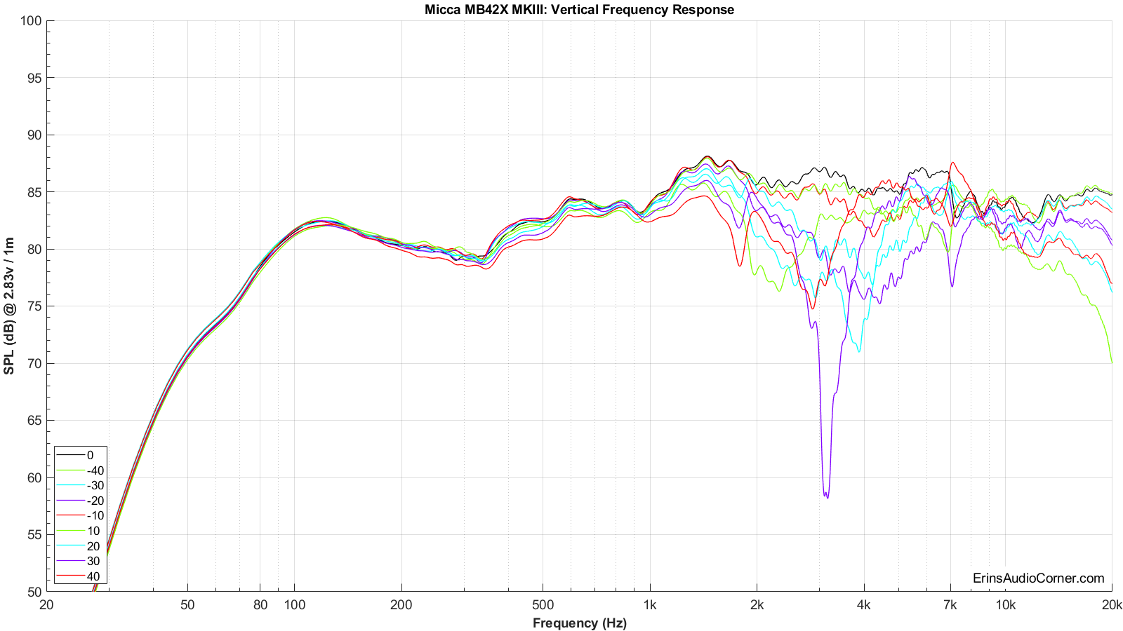

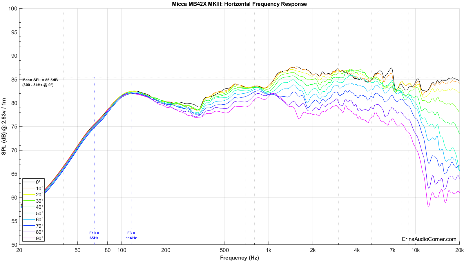

The measurement below provides the frequency response at the reference measurement axis - also known as the 0-degree axis or “on axis” plane - in this measurement condition was situated at the ribbon.
The mean SPL, approximately 85.5dB at 2.83v/1m, is calculated over the frequency range of 300Hz to 3,000Hz. But below about 1kHz it strays vastly from that mean and gets as low as 80dB at 300Hz.
The blue shaded area represents the ±3dB response window from my calculated mean SPL value. As you can see in the blue window above, the Micca MB42X Mark III is all over the place. There is nearly 5dB difference between the midrange and the treble.
The speaker’s F3 point (the frequency at which the response has fallen 3dB relative to the mean SPL) is 116Hz and the F10 (the frequency at which the response has fallen by 10dB relative to the mean SPL) is 65Hz.

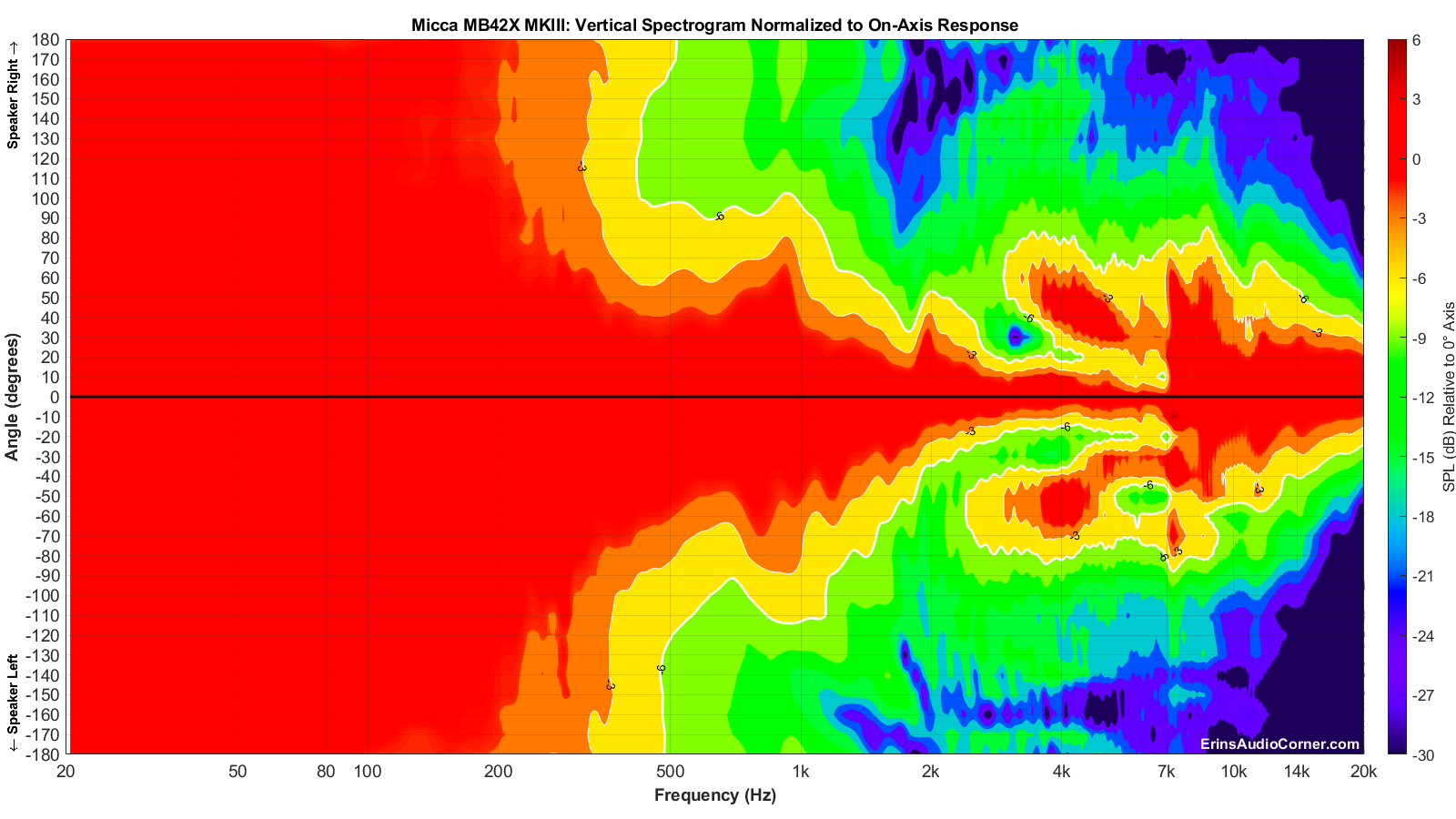

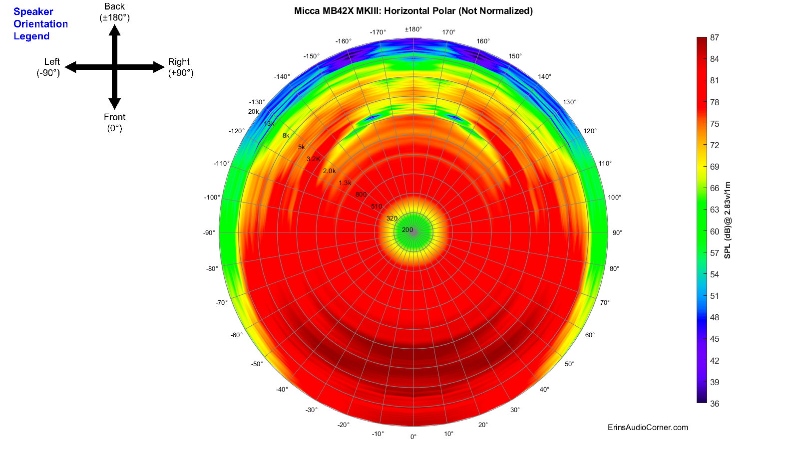

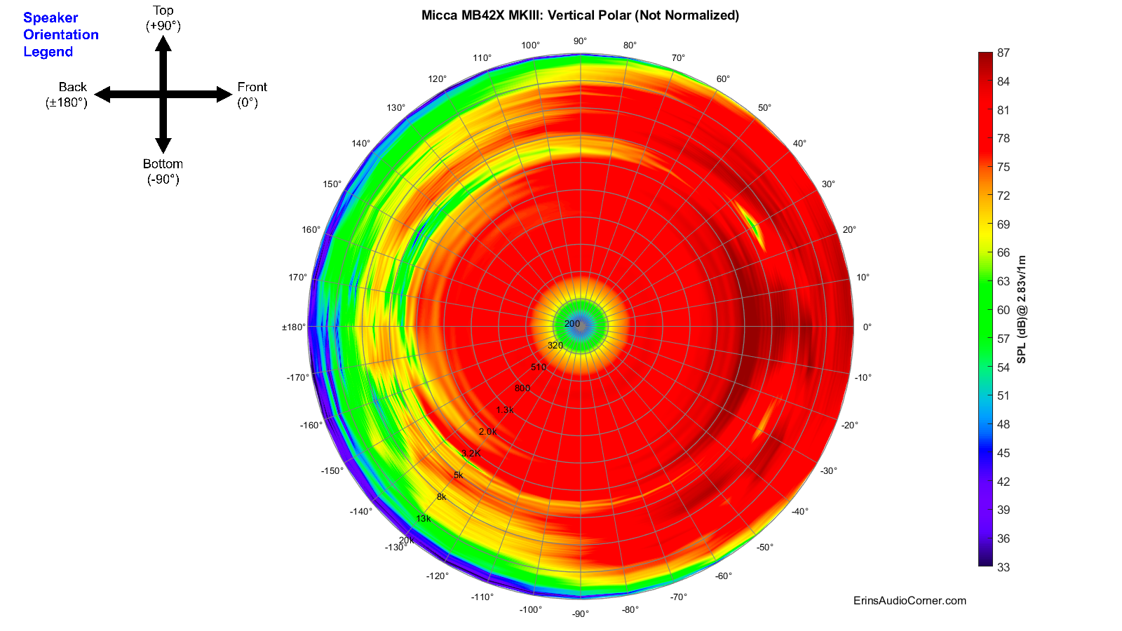

- Full response (20Hz - 20kHz with the angles from 0° to ±180°) with absolute SPL values
- Full, “normalized” response (20Hz - 20kHz with the angles from 0° to ±180°) with SPL values relative to the 0-degree axis

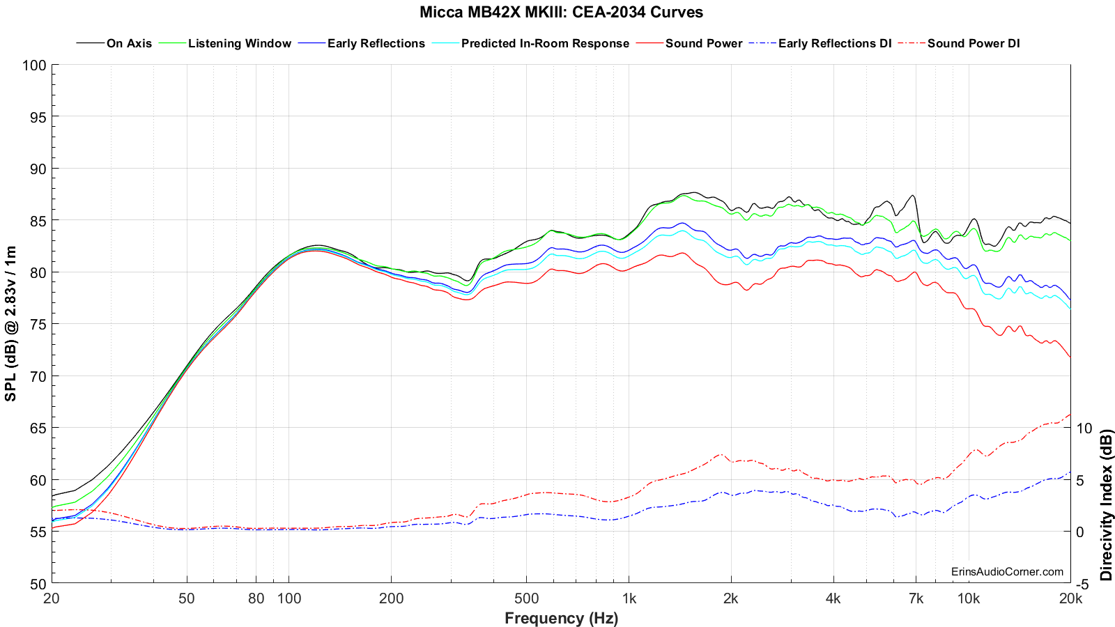

CEA-2034 (aka: Spinorama):
The following set of data is populated via 360-degree, 10° stepped, “spins” from vertical and horizontal planes resulting in 70 unique measurements. Thus, this is sometimes referred to as “Spinorama” data. Audioholics has a great writeup on what these data mean (link here) and there is no sense in me trying to re-invent the wheel so I will reference you to them for further discussion. However, I will explain these curves lightly and provide my own spin on what they mean (pun totally intended). Sausalito Audio also has a good write-up on these curves here. Furthermore, you can find discussion in Dr. Floyd Toole’s book “Sound Reproduction”. Here’s a link if you want to purchase it and help me earn about 2% of the price. And, finally, here is a great video of Dr. Toole discussing the use of measurements to quantify in-room performance.
In short, the CEA-2034 graphic below takes all the response measurements (horizontal and vertical) and applies weighting and averaging to sub-sets and can help provide an (accurate) prediction of the response in a typical room. If there is a single set of data to use in your purchase decision, this is probably it.
Alternatively, click this arrow, if you want my quick take on what these curves mean without going to another site.

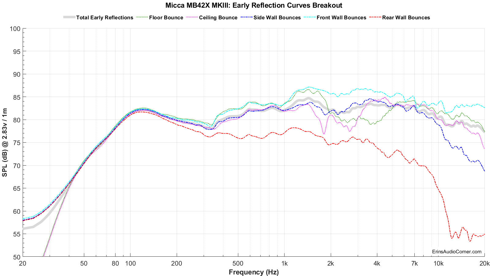

Below is a breakout of the typical room’s Early Reflections contributors (floor bounce, ceiling, rear wall, front wall and side wall reflections). From this you can determine how much absorption you need and where to place it to help remedy strong dips from the reflection(s). Again, as a pointer to the wide horizontal envelope, notice how the Rear Wall Bounces Curve is relatively high in amplitude (for a front-facing tweeter, at least) until about 10kHz.

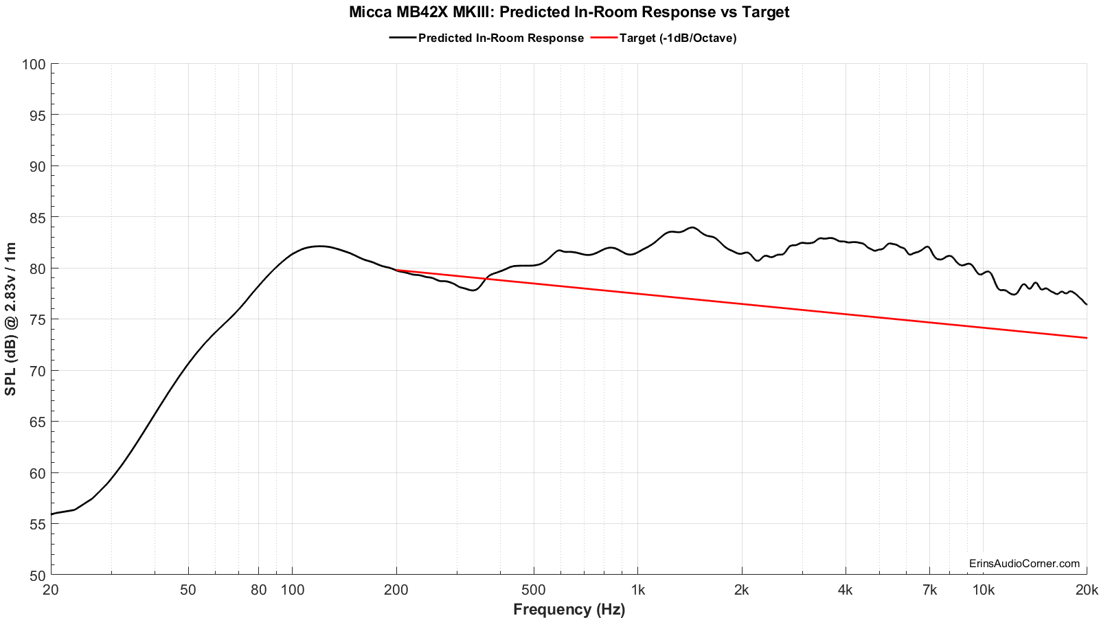

And below is the Predicted In-Room response compared to a general Target curve equaling -1dB/octave.
You may ask just how useful the above prediction is. Well, I’d be remiss for not delving in to that a little bit here. Please see my Analysis section below for discussion on this.

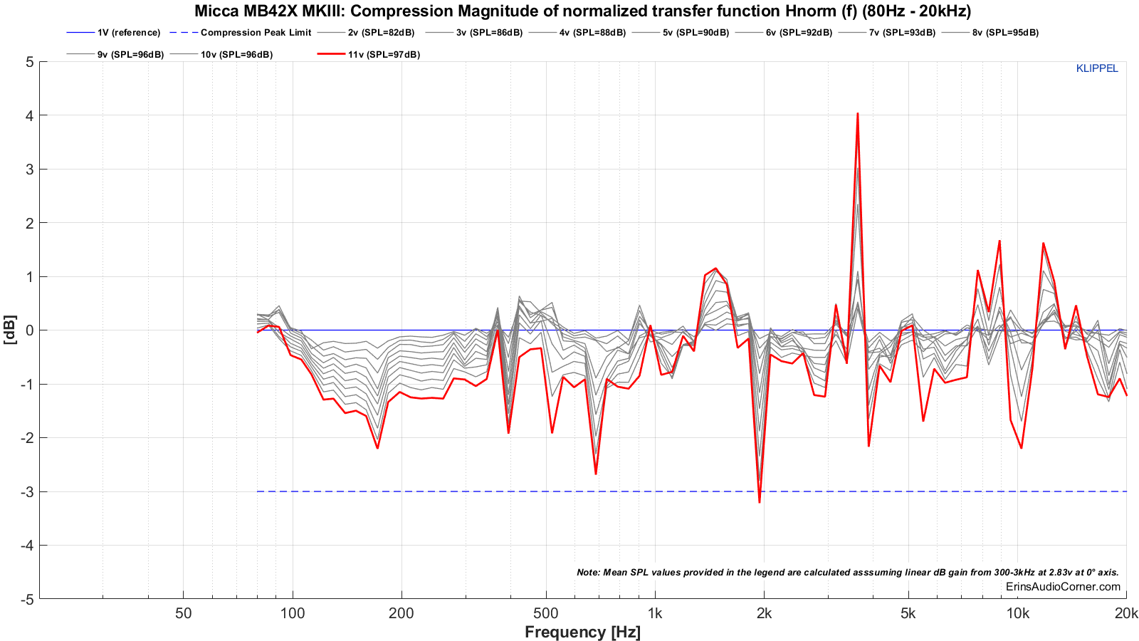

The below data provides the metrics for how Maximum Long Term SPL is determined. This measurement follows the IEC 60268-21 Long Term SPL protocol, per Klippel’s template, as such:
- Rated maximum sound pressure according IEC 60268-21 §18.4
- Using broadband multi-tone stimulus according §8.4
- Stimulus time = 60 s Excitation time + Preloops according §18.4.1
The thresholds to determine the maximum SPL are:
- -20dB Distortion relative to the fundamental
- -3dB compression relative to the reference (1V) measurement
When the speaker has reached either or both of the above thresholds, the test is terminated and the SPL of the last test is the maximum SPL. In the below results I provide the summarized table as well as the data showing how/why this SPL was deemed to be the maximum.
This measurement is conducted twice:
- First with a 20Hz to 20kHz multitone signal
- Second with a limited 80Hz to 20kHz signal
You can watch a demonstration of this testing via my YouTube channel:
- Max SPL for 20Hz to 20kHz is approximately 88dB @ 1 meter. The distortion threshold was exceeded above this SPL.
- Max SPL for 80Hz to 20kHz is approximately 100dB @ 1 meter. The compression threshold was exceeded above this SPL.
- Red = MLP Average (average response in the head area at the main listening position)
- Green = Front Row Average (average across front 3 seats in my home theater)
- Blue = Predicted In-Room Response from the data

Here’s the rundown of my subjective notes and where it fits with objective:
- Overall, I found the max SPL I could drive the speakers to was around 88-90dB at my listening position, depending on the music. In the nearfield listening, the output was about the same level because of distortion limitations; I didn’t like them above 90dB.
- Depeche Mode’s “Enjoy The Silence”: sounds distant; hollow through the entire midrange. No bass below ~160hz. Well, looking at the data we see a big trough smack in the midrange at about 300Hz. The treble is also about 5dB higher than the midrange.
- Steve Winwood’s “Higher Love”: Wide left soundstage; missing something below 1kHz tonally; hollow sounding. Not “involving”. Just “there”.
- Bruno Mars’ “24K Magic”: Biting highs somewhere above 4kHz. Midbass was lacking emphasis.
- The Police “Wrapped Around Your Finger”: There’s nothing in the bassline below about 140Hz.
- Portugal The Man’s “Feel It Still”: The only song that had a positive attribute which was around about 800Hz which sounded the most natural so far. Looking back at the data, this is the only area in the response that is linear within about 1/2-Octave above/below.
- Norah Jones “Tell Yer Mama”: Mechanical noise… Tinsel lead slap? Note, again, the volume wasn’t that loud.
I chose not to run Dirac Live with these speakers because I wouldn’t recommend anyone buy these and I didn’t want to waste my time with these speakers anymore.
Bottom Line
The Micca MB42x MKIII is a terrible speaker if you intend to listen to it as a budget audiophile speaker (or anything resembling that). There. I said it.
Micca lists these “Feature Highlights” on their site:
- Balanced woven carbon fiber woofer for enhanced transient and impactful bass
- High performance silk dome tweeter for smooth treble and accurate imaging
- Highly optimized 9-element crossover with full 18dB/octave* alignment and compensation network
- Ported enclosure delivers extended bass response with low distortion
- Dramatically transformed sound signature that is incredibly open, balanced, and dynamic
Unless you absolutely need a speaker this size, you have the ability EQ until your heart (or ears) is content and you don’t plan on listening louder than talking levels in the nearfield… don’t buy this speaker. Buy the Neumi BS5 if you’re looking for a budget set of bookshelf speakers. That’s an easy, easy decision. Comparatively, this Micca speaker isn’t even in the same ballpark. It’s not even worthy enough to hold a baseball.
