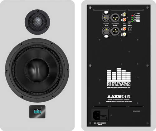

consider these:
And check the spec sheet (no measurements though):
purify woofer, hypex amp, hype dsp (may need lots of time to tune), good cabinet, option for beryllium tweeter, and modular upgradability (hopefully).
About £3000 a pair without the beryllium tweeter option (which you can add later).
based in the uk with 1 year warranty.
Sound on Sound measured one of their models.
consider these:
Kinda funny that their render has no screws in the driver holes.
