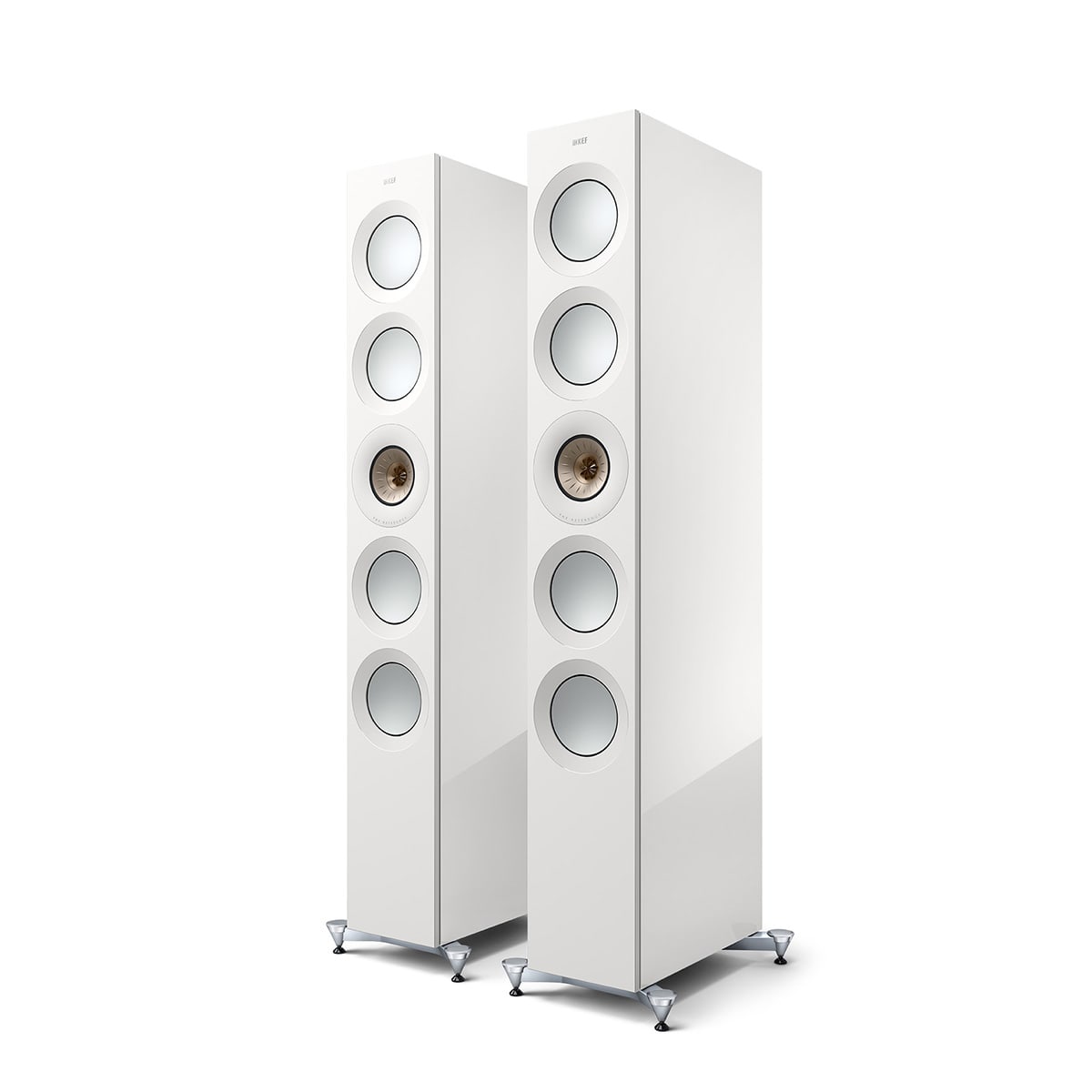

Or alternatively, if you don't like the Blade looks, their Reference 5 Meta:

I find the Refence 5 clean but a bit hard-edged.
OTOH, my wife and I find the Blades to be refreshingly gradeful and are pleased to have incorporated 3 of them into our renovations.
