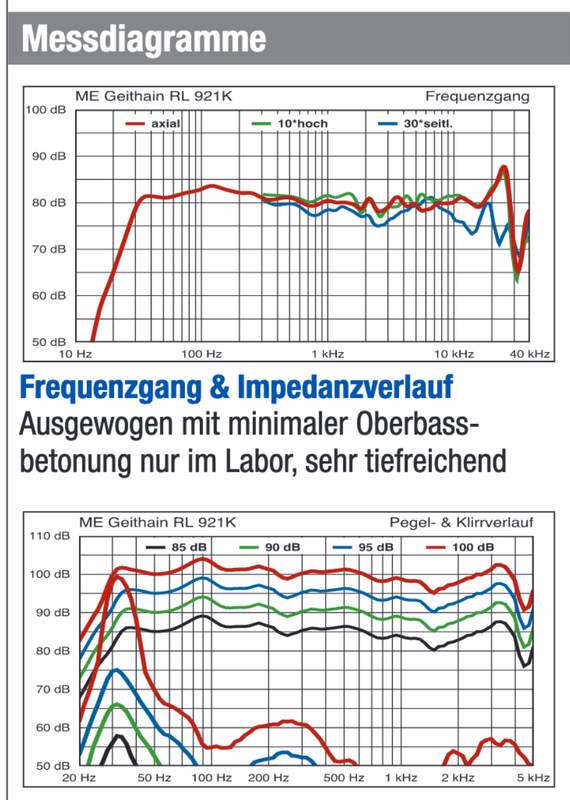

Here are the measurements from stereoplay for Genelec 8361A:
compare with the Geithain 921k:

My guess is that with the W371 bass unit and the way it works filling in nulls the Genelec will achieve a similar bass benefit as the Geithian by a different method.Finally got the 05/2020 issue of the Stereoplay digitally delivered to my account. From looking closely at the graphs I think Genelec 8361A measurements are a bit better - in special the dispersion graphs (imo).
The Geithain 921K goes a bit lower: -3/-6 is 30/26 vs 37/34 for 8361A.
OTOH,The Geithain 921K is not as loud: 98db max level vs 106db for 8361A.
After skimming through the reviews, the reason Geithain 921K would score better is due to the cardioid bass feature that makes it easier to setup and probably gives it better (and deeper) bottom end in the real world.
I think they are very close. In a treated room (or studio) 8361A would win imo.
I wonder about the relatively low powered amp for the 16" woofer. It's 180W "only". The 8" woofer of my old O300D is powered by 130W and the 10" woofer in the KH420 by 330W (@ 10% THD - wtf is that?). Surely a 16" woofer could handle even more power and might reach more than 98dB SPL. Maybe mid and tweeter are the limit.The Geithain 921K goes a bit lower: -3/-6 is 30/26 vs 37/34 for 8361A.
It's very strange.OTOH,The Geithain 921K is not as loud: 98db max level vs 106db for 8361A

It is not as strange when you consider that the Genelec use their rear side bass drivers output to increase the spl (bass reflex, almost 6 dB extra) while the Geithain K models use it to decrease the spl on the back (cardioid, up to approximately 8dB less on the rear). For the same reason (that cardioid bass costs spl) the D&D 8c is not cardioid in the lower bass and the Kii Three cardioid bass extension is as big and expensive as it is. Like almost always in nature there is no thing as free lunch and quality and quantity are antagonistic properties.It's very strange.
Peak SPL from 100 Hz up is at least 115 db/m.
Maybe they calculated it by limiting THD, but 12" woofer is at least same displacement as Genelec's twin ovals, so I don't know.
I've got this Stereoplay article.It is not as strange when you consider that the Genelec use their rear side bass drivers output to increase the spl (bass reflex, almost 6 dB extra) while the Geithain K models use it to decrease the spl on the back (cardioid, up to approximately 8dB less on the rear)
