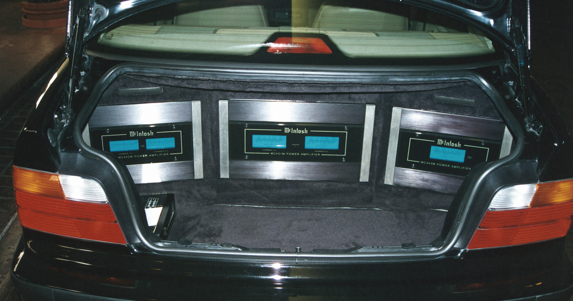

I recently saw one in the dash of a car that had a McIntosh amp in the trunk. It came from the Callaway factory that way in a:
C9 (Callaway Impala SS)​
[edit]
The Callaway SS integrated the 400 bhp/383 cid SuperNatural engine used in Callaway Corvettes and Camaros with the impressive Chevrolet Impala SS. The Callaway SS also included suspension, braking, wheel and tire enhancements.
There were 3 produced with the Tremec 6 speed manual transmission and one of those was produced with the 450 bhp/383 cid SuperNatural engine.
That was the one that I saw for sale in Charlotte, NC with the McIntosh gear in it. It only had 52,000 miles.
If I had only had an extra $50,000 handy, I would have bought it.
