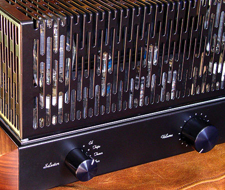

Stereophile reviewed the 300B SE which might be the version before the compact, not sure. Might be your cup of tea.

Graph from Stereophile
Fig.2 Mastersound 300 B S.E., 8 ohm tap, frequency response at 2.83V into: simulated loudspeaker load (green), 8 (red), 4 (blue), 2 (magenta) ohms (1dB/vertical div.).
This is more my notion of good.
