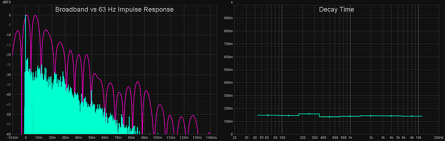

I agree with dfuller, but I would add that acoustic treatment is essential in a commercial mastering studio.
Personally, I would never send a file to a studio if I don’t know the RT60 at the listening position, and if it’s not flat at least down to 40 Hz.
That's what a good mastering studio acoustic should look like : The studio i work with when mastering
That eliminates a huge number of studios, but they’re the only ones that allow me to be confident there won’t be major issues when listening elsewhere and break the ASR famous circle of confusion. ;)
