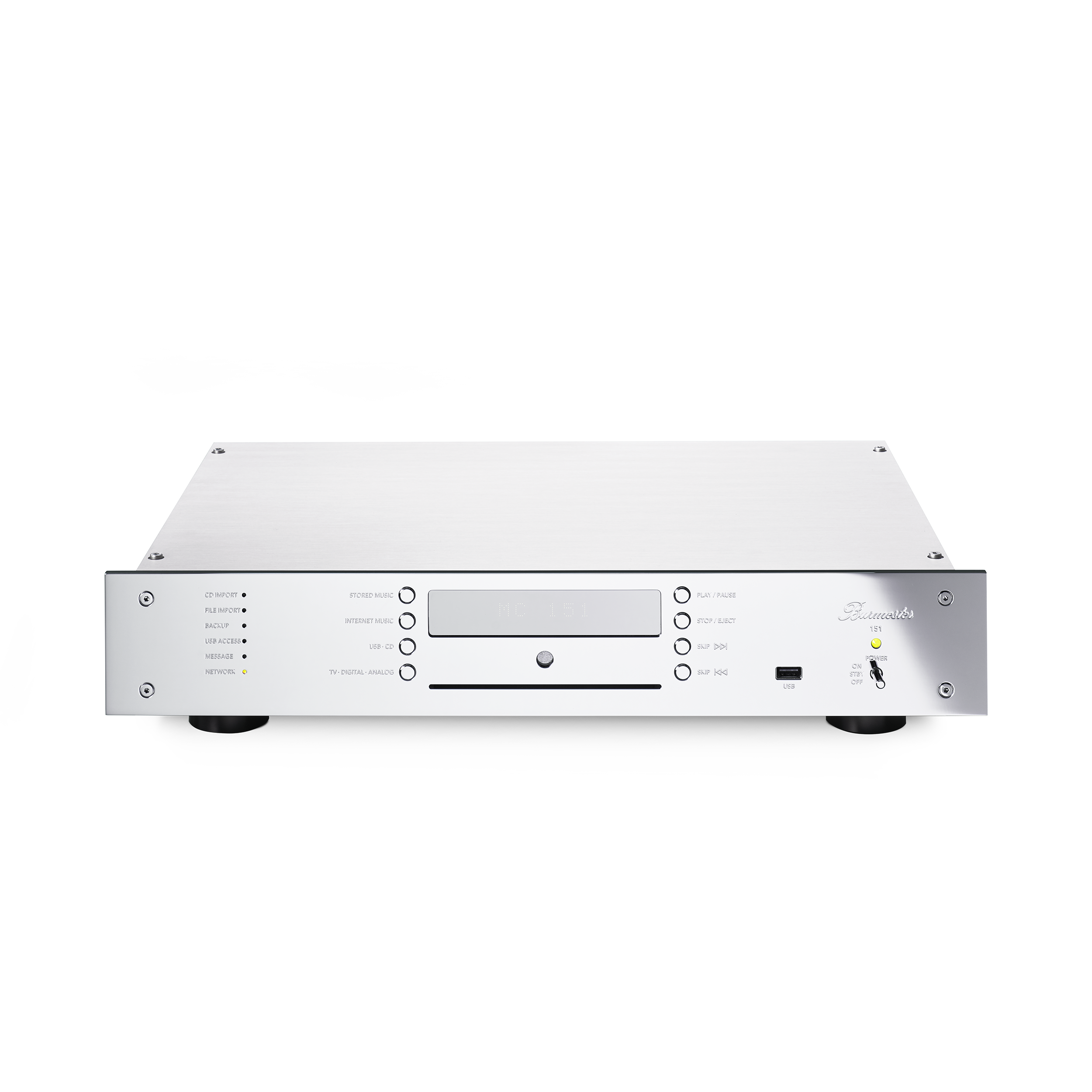

…aaaaand then there’s this, a steal at $27,500
