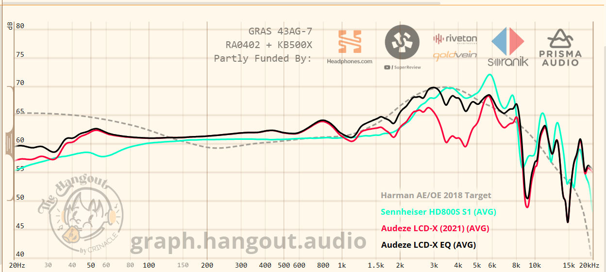

In room measurement at listening position with 1/6 smoothing...:
Was it successful? Absolutely. Tonal balance now matches so closely that hi-hats, bass weight and vocal brightness line up one-to-one. (Vocals on the LCD-X have a touch more body—no room cancellations.)

(Graph: LCD-X EQ vs LCD-X stock vs Sennheiser HD800S. TL;DR: fuller bass than HD800S, smoother 5–8 kHz, a bit of top-octave air.) - ... and yes, - I have listend to the HD800S IRL.....

I used oratory’s well-known profile as a foundation, then tuned by ear to better match my iLouds in-room.
  • Bass contour: oratory uses two boosts (≈+3.5 @ ~26 Hz and ≈+5–6 @ ~105 Hz).
    Mine: a single low shelf at 30 Hz +3 dB → keeps real sub-bass but less mid-bass bloom, closer to what my nearfields measure in-room.
  • Upper-mid lift: oratory’s +7 dB high-shelf @ 1.8 kHz can run hot.
    Mine: a milder +4.5 dB shelf, plus the familiar −2.9 dB @ 2.67 k and +4 dB @ 3.85 k for clarity without shout.
  • Low-treble control: both tame the 5–6 k region.
    Mine: a narrow −5.2 dB @ 5.65 kHz stays, but I voiced the rest of the top end to sound like speakers.
  • Brilliance/Air: oratory uses a strong 9 kHz cut and stops there.
    Mine: a big −6 dB shelf @ 9 kHz plus +2 dB @ 14 kHz → darker “brilliance” (8–10 k) with a touch of top-octave air, which mirrors how room treble decays off-axis.
Net effect: Compared to oratory, my curve is less mid-bass heavy, less upper-mid hot, darker in 8–10 k but airier above 12 k—which is why it lines up with my iLouds.
