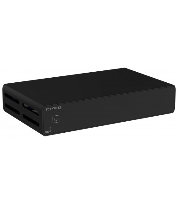

Topping responded to me on their Facebook page—Class AB.
I just placed my order for a pair from Apos. Hoping it is in stock, as they did not mention that it is a preorder anywhere on their product page. Topping also selling it from their official store on AliExpress, but they’re charging $654 for a pair of them there, whereas Apos has them for $299 each.
-Ed
@EddNog
Sorry about that. It's a mistake.
I need to clarify here that the B100 is a Class B amplifier.
Class B. Look at the bandwidth.
That is wider than any class D I've seen measured.
But then - as @Zek states - Class B would be a fairly unique design. I've not seen any of those either.
Aren't most small AB amps class B really?
That was my understanding all these years.
And for the bigger class AB ones,operation is A class for the first few W and then they go class B.
I'd love to learn the truth here after all these years!
