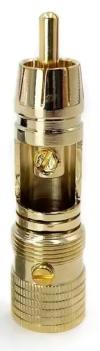

RCA Cable Wire performance upgrade
Make a mental note the higher quality RCA cables I bought and was using before have a housing I could undo and use only 22 gauge wires, not sure if that size is the standard or if they get even skimpier :facepalm:
If you have no real soldering experience it can be tricky as if you heat too much waiting for that mirror finish look on the solder the nylon ring around the center pin might deform a bit and pin will be misaligned so using the RCA extender plug mentioned below and in the picture is highly recommended.
I had it happen to me on 2 ends but they are still usable I was able to bend them back as it was very minor alignment issue just not ideal as you could damage your plug in port.
So gathering the wires having them pre twisted together and ends you want to be soldered to then having a professional do the soldering would be a great idea just ensure they use a RCA plug so the pin stays put.
16 Gauge flat wire, or you will most likely have to strip much more of the wires to make distance from the ends to make it easier to assemble and solder.. And you`ll need more heat shrink tubing for the exposed lengths of bare wire so the flat wire is best. But regular fatter speaker wire will do if that all you have just forget the housings and use heat shrink tubing in there place.
The flat wire is more of an issue when soldering TRS and XLR ends as you want as much space as you can get but again if your not concerned about using the housings you can probably get by using regular fat speaker wire.
XLR will be the most challenging if using fat wire and not the flat skinny wire I put in the images as you will probably want to use the housing due to it`s locking tab...
24 gauge wire.
Depending on the style of RCA ends you choose to work with, some have screw holes some have open top design, From my experience I`ve only used the screw design the a single strand 16 gauge and single strand 24 gauge will fit inside the port hole once the screws are removed as they are not used in my design.
With the screw designs I remove the screws install wires into the port slot and solder from the screw hole . The wires has been very secure so far it would take much effort to pull it out after soldering and if done right with a mirror finish the wires would be the breaking point. Cold solder points are just as good as cheap glue so have fun and take you time.
I haven't tried the open top solder designs the screw port is solid so no need for me personally to attempt something new.
Also soldering to the flat area of the housings is not a great idea as it`s thick and takes more time to heat up so more chance of the solder falling off after a few movements of the cables.
Another heat warning is to use RCA extender ends with female holes to prevent the positive pin from moving when soldering I added a picture below showing.
I`ve used 2 brands of RCA ends. The DIYLIVE & The Seawell deadbolt brand. Sewell I was NOT able to use the housing after soldering the negative wire so I just used heat shrink tubing to secure everything and make it look a bit better the ends don`t matter to me they are not out in the open and not an eye sore.
The DIYLIVE brand you can install the large part of the housing after soldering the positive wire then solder the negative wire in the lower screw hole then use heat shrink tubing as the tiny end ring will not fit over the soldered area.
So my opinion is to use the DIYLIVE in the picture below and is overseas online popular site I use only for less expensive purchase`s with no worry about returns.
13mm heat shrink tubing fits over both Seawell and DIYLIVE housings so if you wanted to add some professional look you can use it to secure the Expandable braided cable sleeve I use in the speaker wire post above.
Take notice that I have experienced a static noise in TRS cables that used a clear rubber tube to insulate between the housing, and the solder point wires and tabs did not have shrink wrap on them.
So if you have not used heat shrink tubing to cover the solder points and you are experiencing a static noise after using Heat shrink tubing instead of the housing I suggest you start your problem solving by removing the outer shrink wrap to see if that is the cause for static.
If that is you can buy liquid electrical tape apply to the exposed solder points allow it to cure then the static should not be present.
  • RCA Male end with long tail and hollow solder designfor positive 133843.png

The picture of the TRS- XLR cable with the opened housing I`m using already and it is good quality I just want to upgrade the wires so to be clear this is not my soldering or upgraded wires I bought it this way and will be cutting wire off and soldering my wires upgrade on.
I could remove the wires and solder on my upgrade design wires know but I wanted to take it slow and have fun with it so I ordered connector ends sperate so I can still enjoy the new pre amp.
I added some pictures of ends I found and wanted to try copper pins and solder points so didn't order the MFL even thought they are said to be comparable in quality to the Neutrik XLR ends as some of the cheaper ones people complain about the plastic melting but they might not have much soldering experience ???
