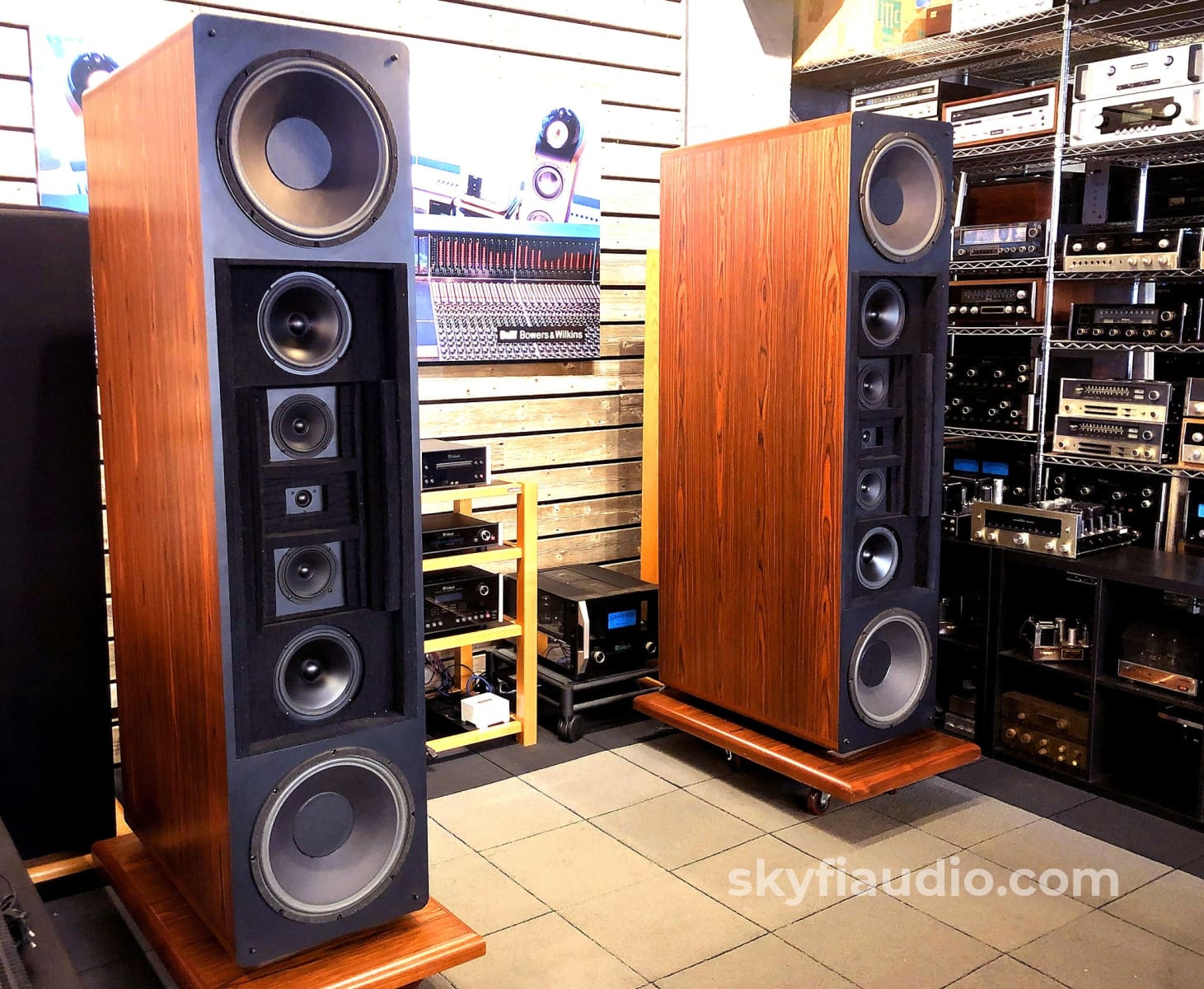

You cannot overcome physics law. Here is an example of sealed speaker reaching 20Hz:
Blade 2 Meta is ported. It is unsurprising that it extends deeper than a sealed box.
F3 at 40ish hz with a 12dB/oct roll-off means you actually have pretty good extension in-room vs a ported speaker with the same F3. Not really bass-shy in real life. Free field, maybe.
