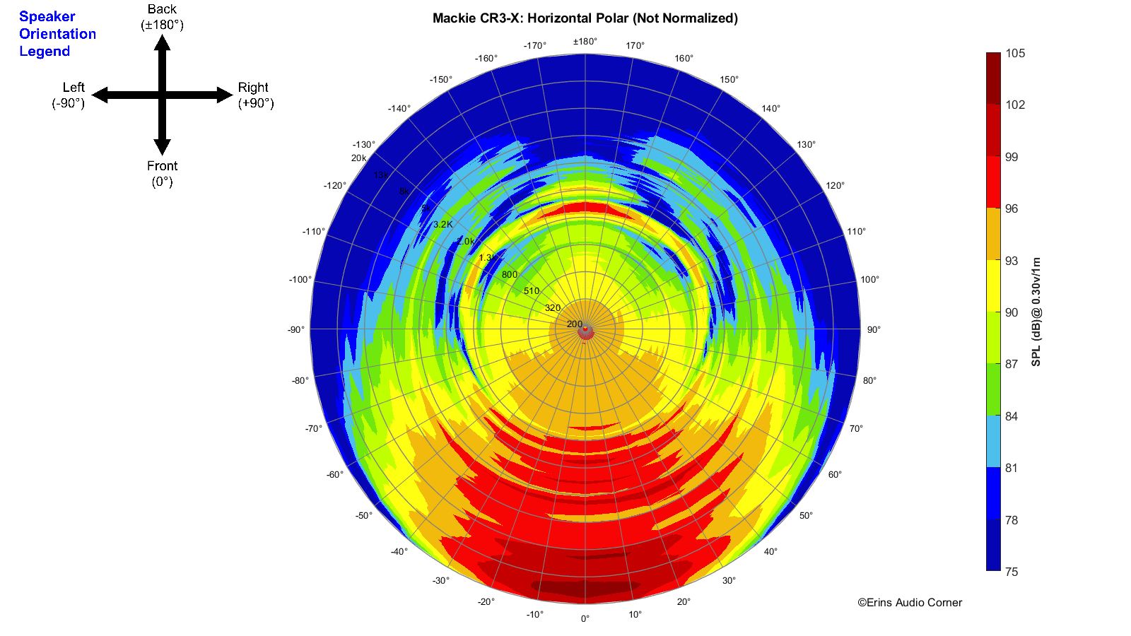

CTA-2034 / SPINORAMA:
Early Reflections Breakout:
Estimated In-Room Response:

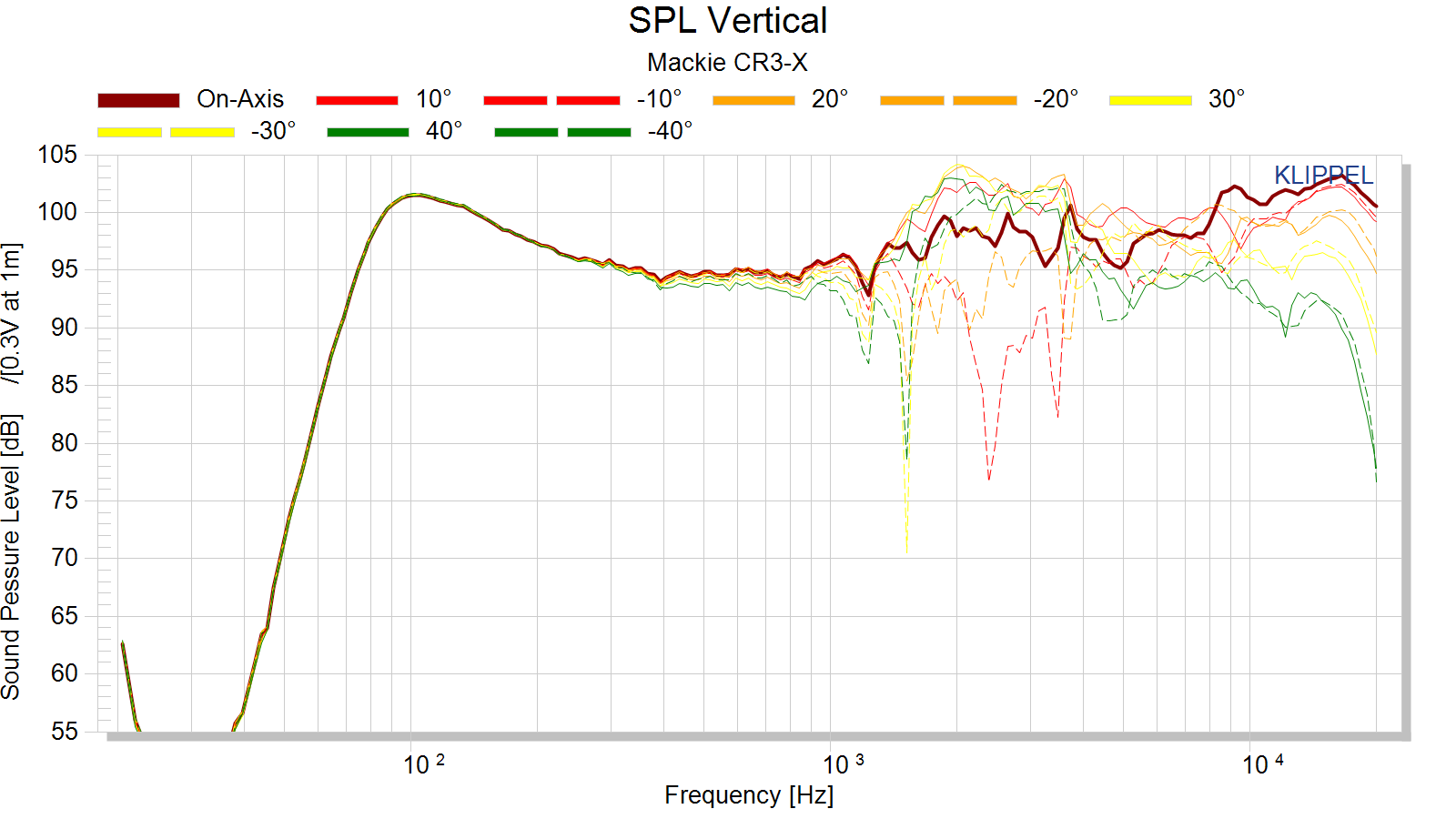

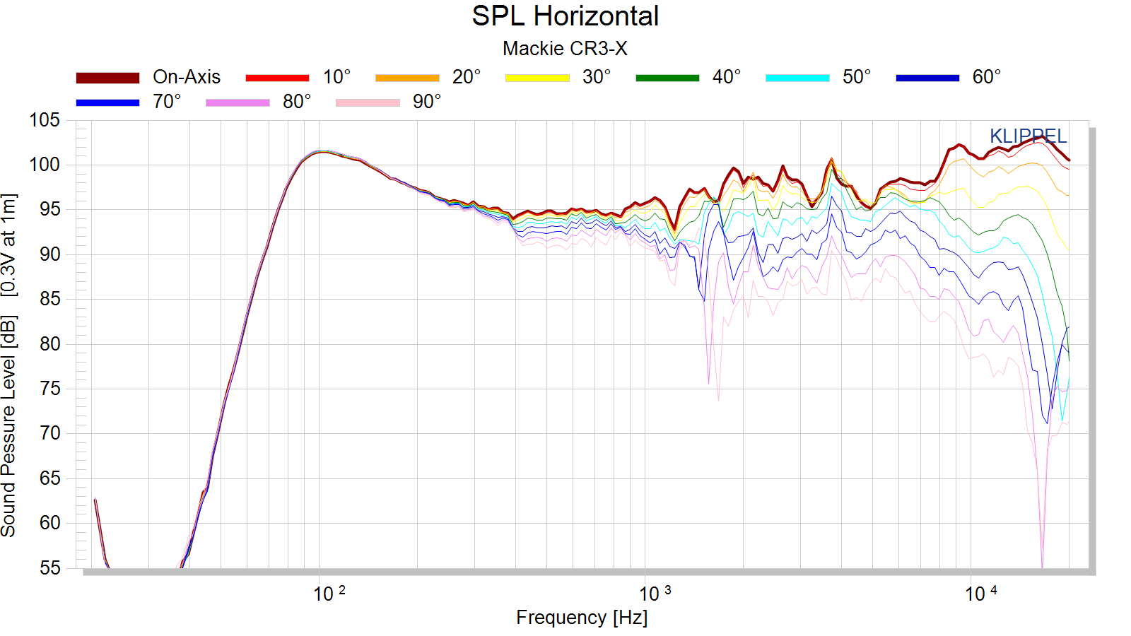

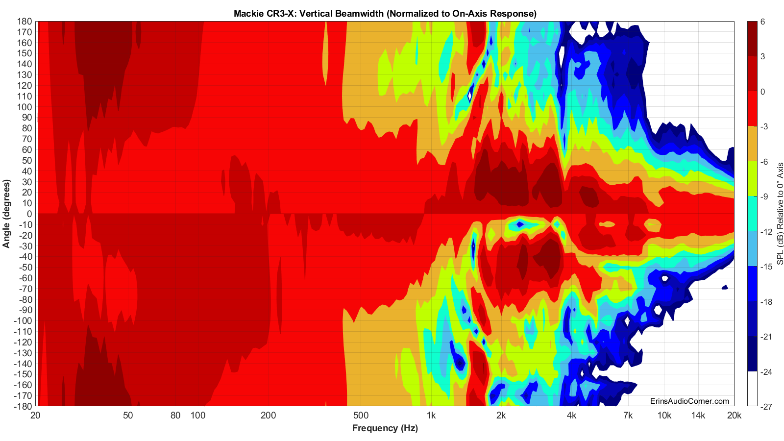

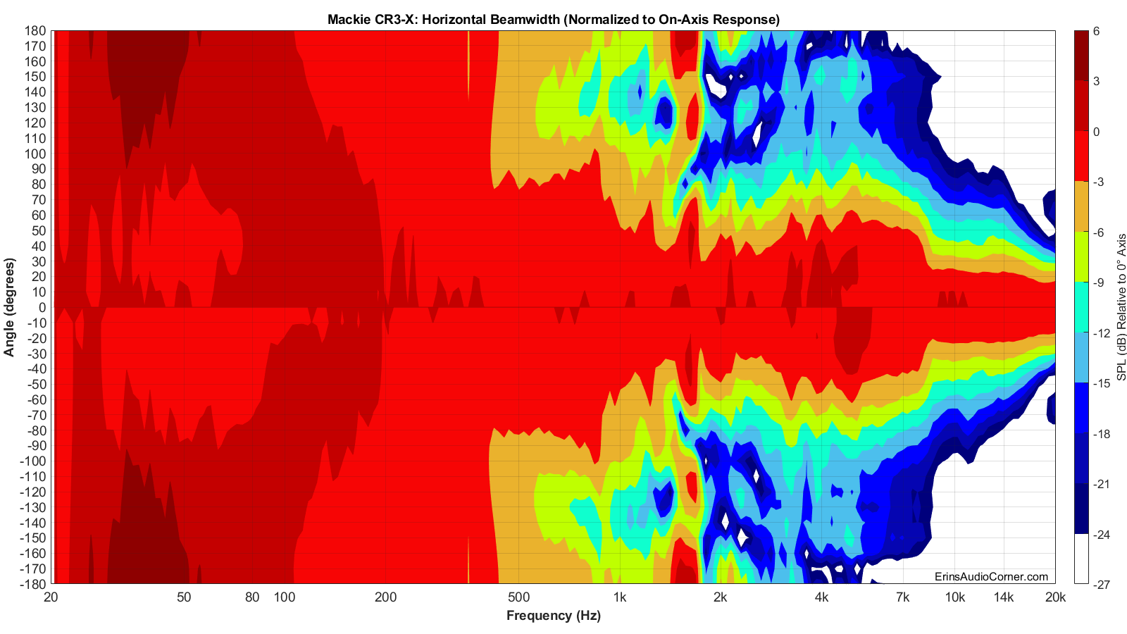

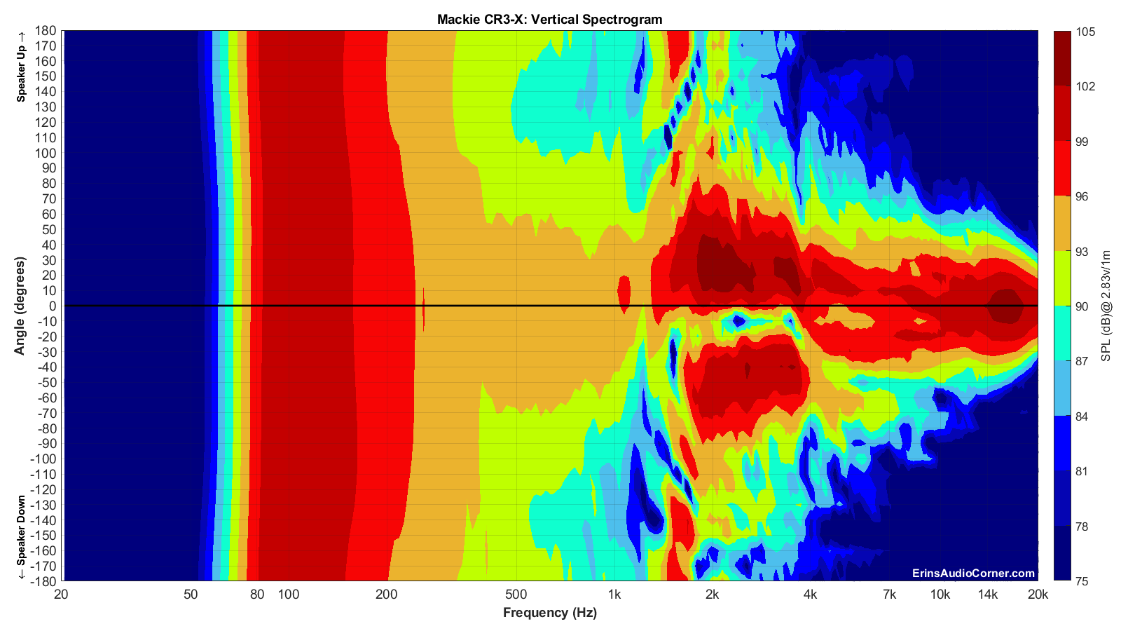

On-Axis Response Linearity

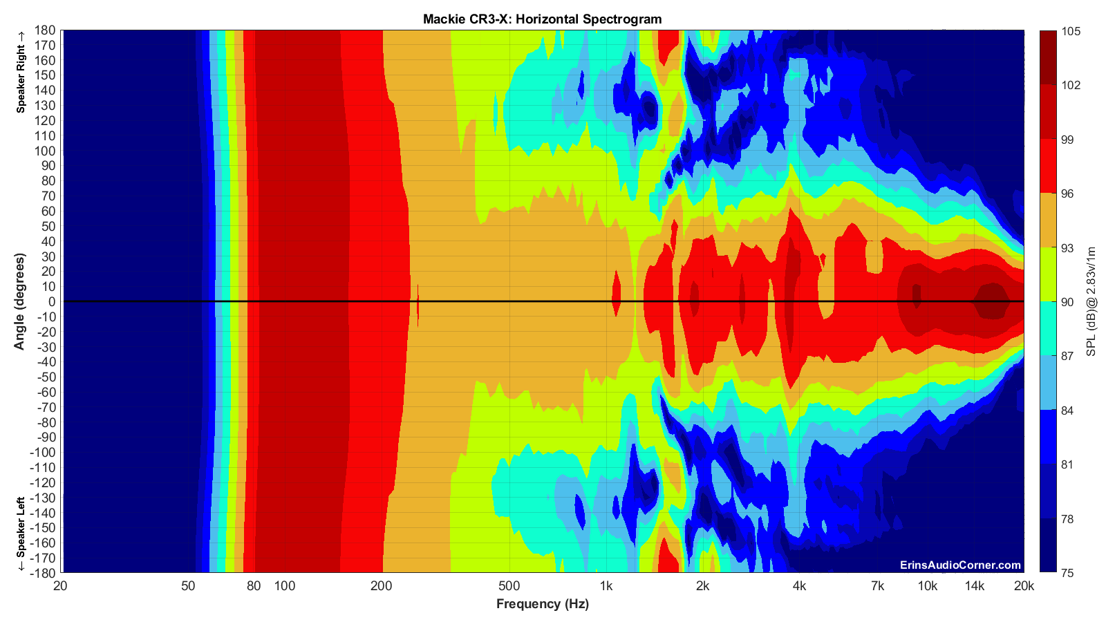

“Globe” Plots
Vertical Polar (Globe) Plot:

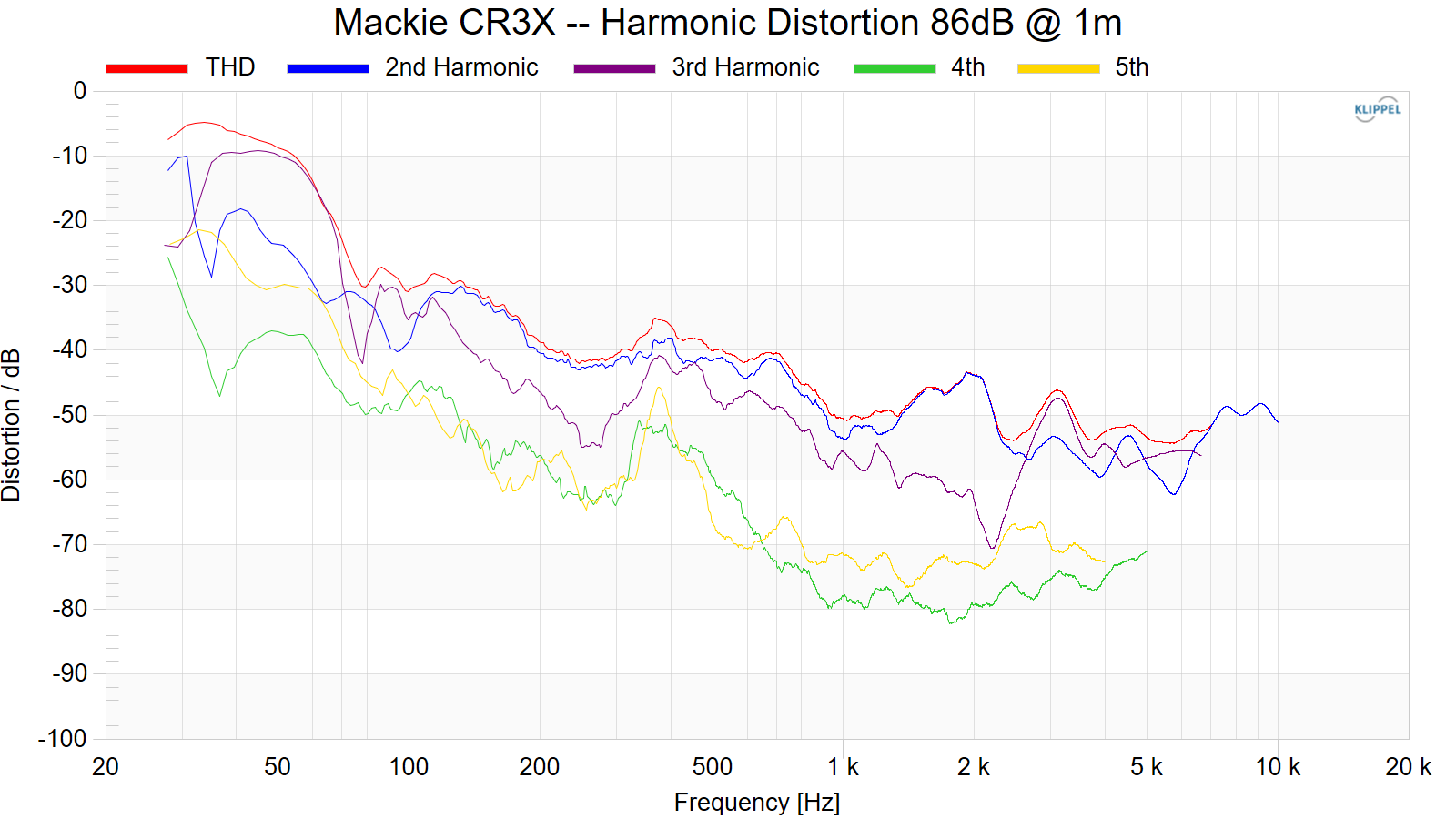

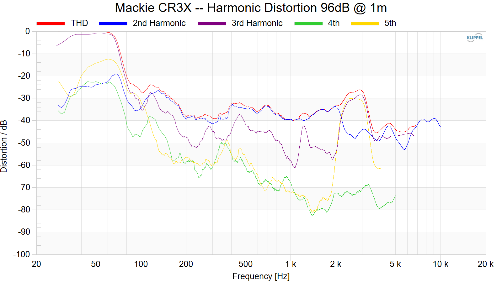

Harmonic Distortion

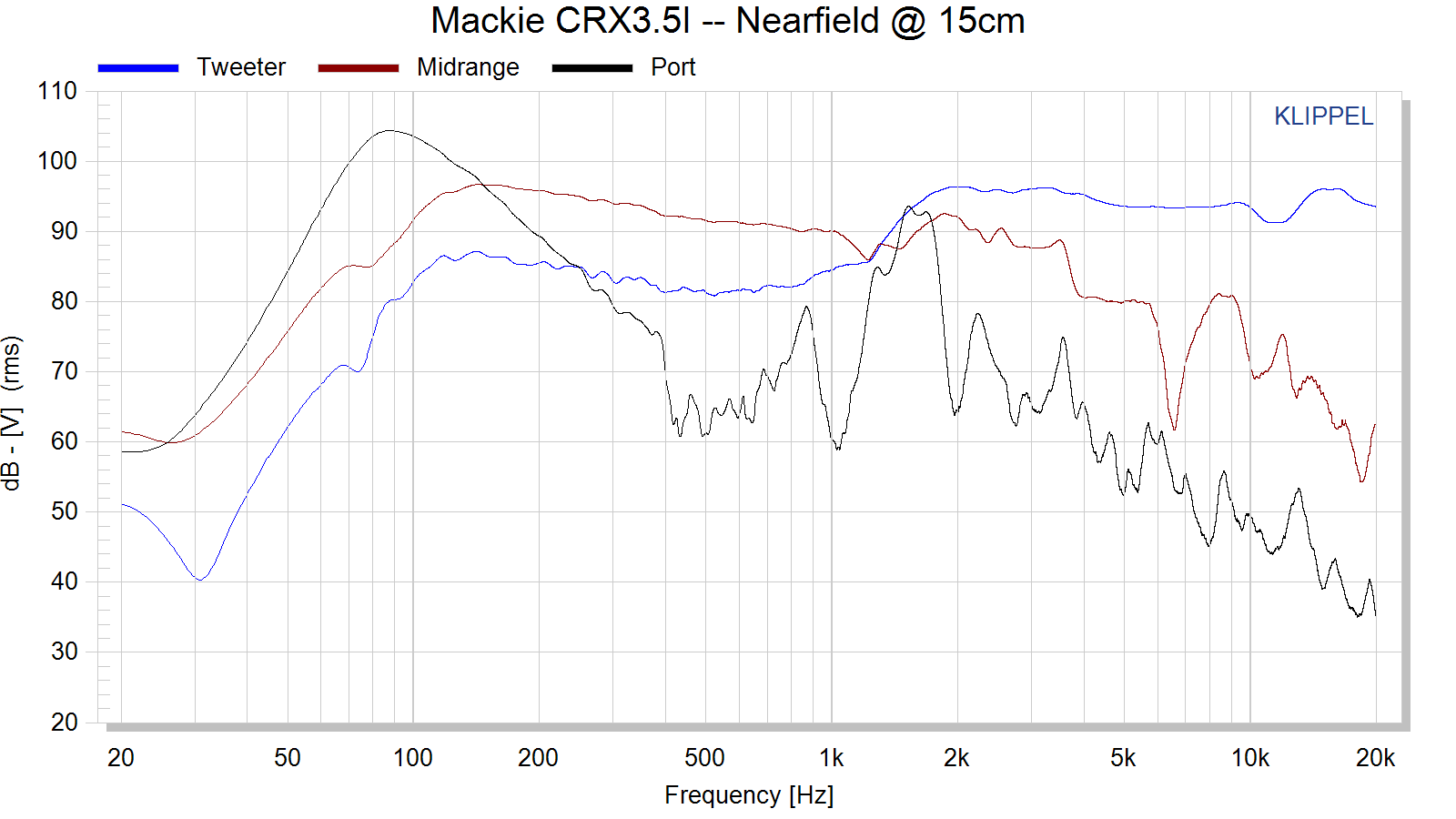

Near-Field Response
Nearfield response of individual drive units:

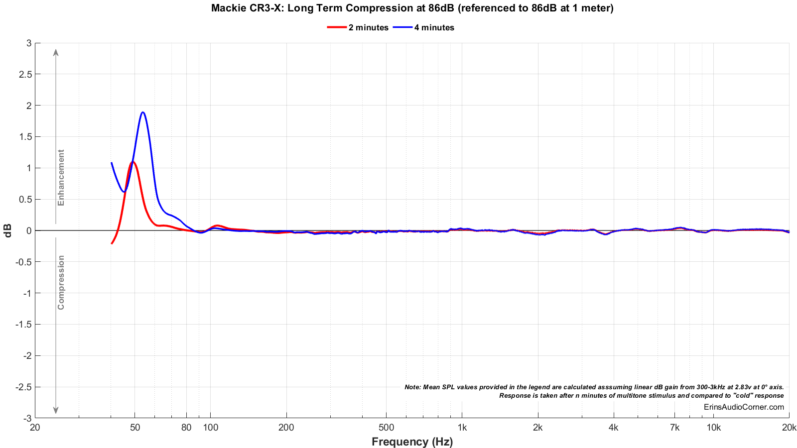

  2. 86dB at 1 meter (red)
  3. 96dB at 1 meter (blue)
  4. 102dB at 1 meter (purple)
Based on my results above, it is obvious the output is strictly limited. These are not designed to play with a lot of output and instead are best used as computer speakers at moderate volume levels.

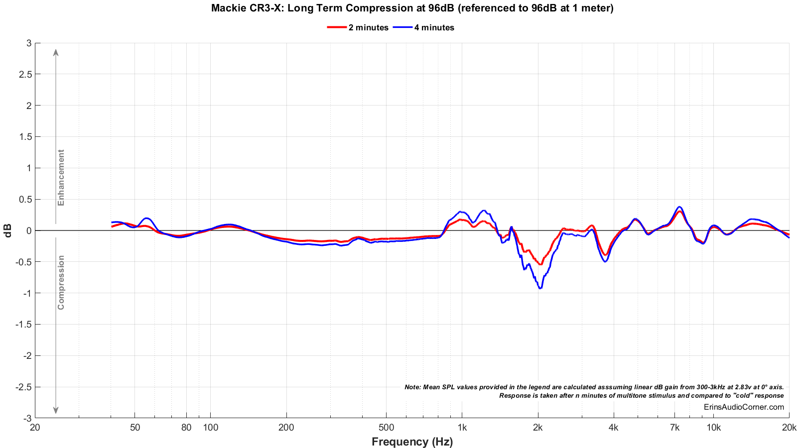

Long Term Compression Tests

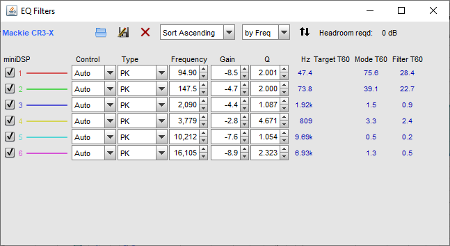

DSP Suggestions
If you have the means, I recommend using EQ to help flatten out the response and achieve a more neutral response, as a set of monitor speakers should provide. Doing so will help immensely and is necessary in my humble opinion. I have provided an example created via REW software’s auto-EQ program based on a standard miniDSP. It is provided in a screenshot below. If you need help understanding how to use this, I encourage you to check out NoAudiophile’s page here which also has other DSP suggestions for various speakers. It is a great resource for this type of thing.

The raw data with corrected ER and PIR:
Score no EQ: 2.2
With Sub: 5.0
Spinorama with no EQ:
  • Bad
Directivity:
Better stay at tweeter height
Horizontally, better toe-in the speakers by 10/20deg and have the axis crossing in front of the listening location, might help dosing the top end.
