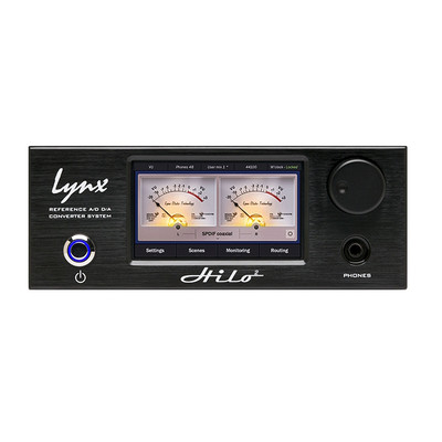

This is a review and detailed measurements of the Lynx Hilo 2 Audio Interface (ADC & DAC). It is on kind loan from a member and costs US $4,139 ($3,599 as tested).
As you see, the unit sports a large, touch sensitive display. Alas, I find the design both dated and unrefined. I was hoping that the oversized display would make it easier to find options and manipulated them but it is not. Granted, most pro gear is the same way but the competitor displays are much smaller. As a pro that would use this as a tool, I guess you will get used to it. But for me as a reviewer, it was still somewhat of a challenge.
On plugging into my Windows 11, I did not see the OS discovering it. I went to drivers for the device and was surprised that the last update for Windows 11 was 2019! There are much newer versions but are for newer interfaces such as Thunderbolt which is available for this unit, but not the version I tested:
