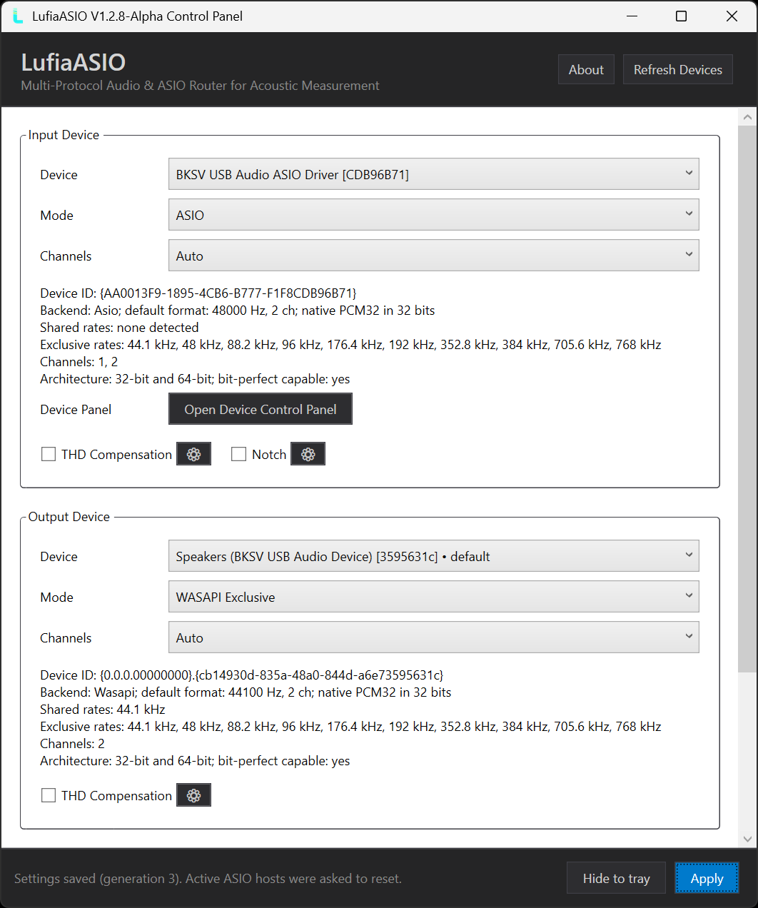

Hi everyone. I am Aspirin, the developer of LufiaASIO. Version 1.2.8 Alpha is my first public preview release.
LufiaASIO presents one ASIO device to a Windows host, while allowing the actual input and output backends to be selected independently. The primary use case is an audio or acoustic measurement bench where the preferred ADC, DAC, host application, and driver do not naturally fit inside one conventional ASIO device.
Official site: https://lufiaasio.github.io/
LufiaASIO 1.2.8 Alpha control panel.​

  • Native-ASIO aggregation: one ASIO device in the host can capture through one vendor ASIO driver and play through another, if both vendor drivers permit simultaneous access.
  • Native WASAPI Exclusive format probing: the endpoint is queried directly rather than being limited to the sample-rate list displayed by the Windows Sound control panel.
  • Host buffers from 512 to 1,048,576 frames: intended to cover responsive operation as well as long FFT and recording workloads.
  • Observable diagnostics: discontinuity, FIFO underflow/overflow, callback, frame, and maximum-watermark counters are visible in the control panel.
  • Stable device recall: profiles follow the backend's native device ID rather than relying only on a possibly duplicated or reordered display name.

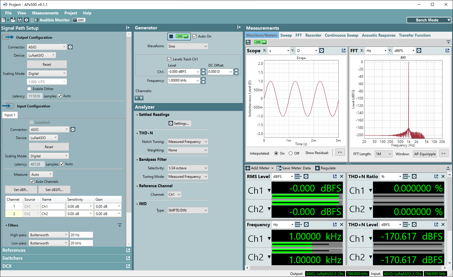

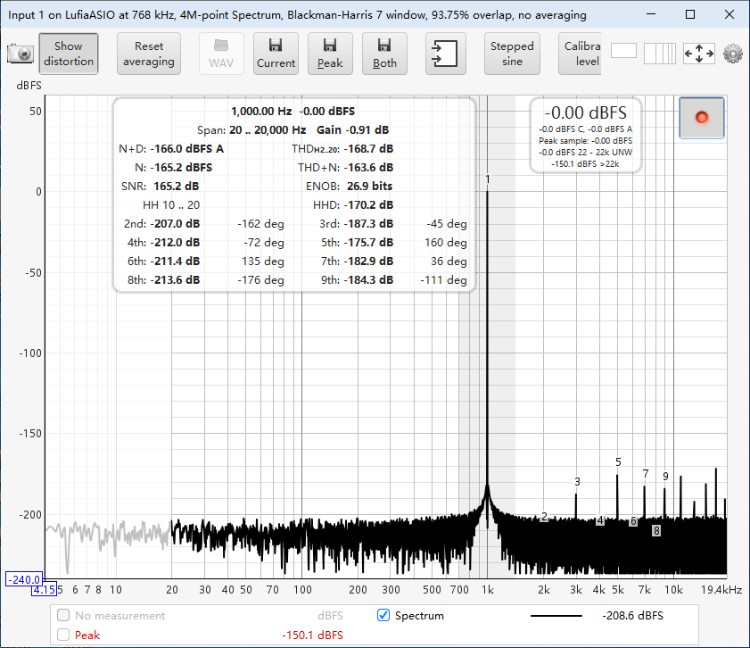

In APx500, LufiaASIO can act as the ASIO connector while either direction is routed to native ASIO, WASAPI Exclusive, or WDM-KS. In REW, it can combine the input of one interface with the output of another without abandoning the ASIO host path. It can also prevent REW from becoming unresponsive when audio devices are frequently disconnected and reconnected.
APx500 — 768 kHz digital-loopback example
Room EQ Wizard — 768 kHz digital-loopback example
The displayed results belong to the pictured Brüel & Kjær/XMOS digital-loopback setup and are not guaranteed specifications for other hardware.

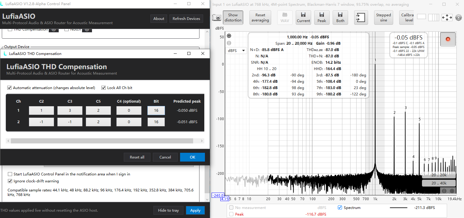

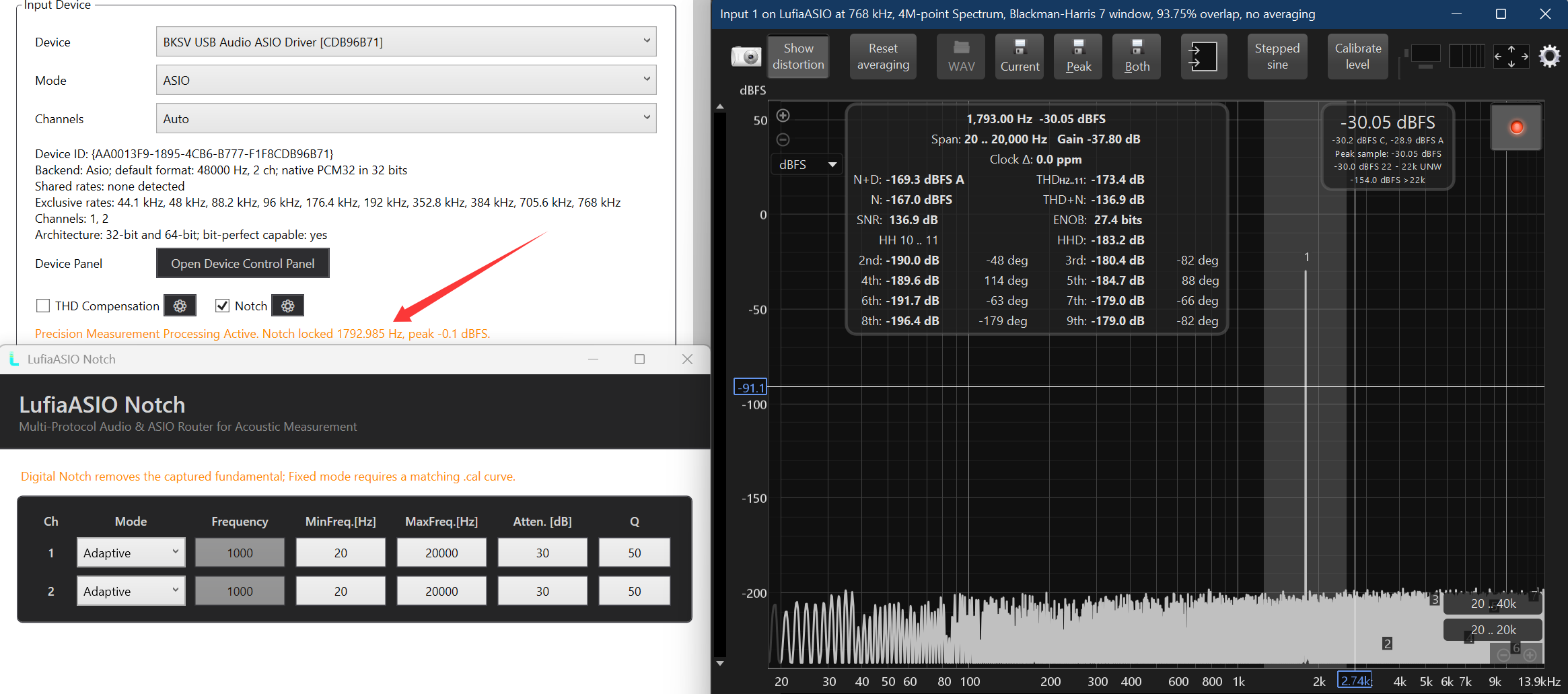

LufiaASIO also contains per-channel polynomial THD Compensation and an Adaptive/Fixed digital Notch on eligible native ASIO and WASAPI Exclusive routes.
  • THD Compensation is intended for a calibrated chain with coefficients tied to the device, channel, level, load, and setup.
  • Adaptive/Fixed Notch suppresses the captured fundamental so residual harmonics and noise are easier to inspect.
  • Both tools intentionally change sample values. They must be disabled for bit-perfect transport tests, and any result obtained with them must identify the processing as part of the measurement method.
  • A processed result should always be compared with a clean, unprocessed baseline.
Per-channel THD Compensation
