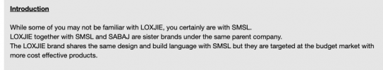

Isn't Loxjie a budget sister brand of SMSL?
Hmm, all I could find regarding that is this snippet from a head-fi review:
Link
Nothing official though, and no obvious connection on their respective websites on the About and Contact pages
Loxjie is a trademark of Shenzhen shuangmusanlin electronics Co.,Ltd..
Sabaj is a trademark of Shenzhen shuangmusanlin electronics Co., Ltd.
SMSL stands for ShuangMuSanLin technology Co., Perhaps a trademark specialist can say exactly what this means, whether it means the factories/designs are identical, or only that SMSL owns the right to sell the brands. They are certainly closely related.
This topic was previously discussed in the much maligned Loxjie D20 thread. Mandy indicated the factories were different.
