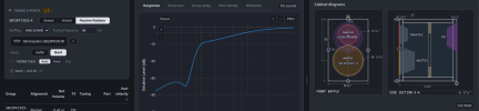

LoudspeakerLab now supports passive radiators, multiple ports, and pre-built cabinets. Also, @technodanvan, you should find some Beyma drivers in the catalog too :)

Big update! I still need to get in there sometime to check out the last update. Got some time off upcoming so I'll see about getting in there.
Edit: Is there a place to add a second PR?
One PR for right now. I’m thinking about making it possible to add PRs to the sides and opposing sides. This starts to creep into territory that is much more niche in terms of design and adds a fair amount of simulation complexity, like open baffle, bi/di-pole speakers. I’m not sure the juice is worth the squeeze because this represents such a small % of designs overall. Curious to hear feedback from others about their ‘must have ‘ features.
