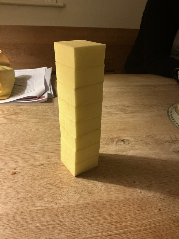

The Sylomer SR-11 tower of power!
It is quite odd, it feels as though it could be damp, though that might be because we have had 41 consecutive days of rain!
About £3.00 per block, now if I only had some speakers to place them under, wait who’s at the door?

I have ordered some SR-11 to try, each 25mm x 50mm x 50mm pad sells for the princely sum of £2.50.
I will report but they look a viable alternative to sorbathane.
