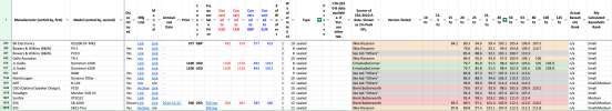

Sweetchaos' Subwoofer Comparison Spreadheet has 116 subwoofer models with sealed construction and betwen 31 and 36cm depth (to include 31.89cm etc.)
From there, it's just a matter of going through each to check the location of the ports and so on.
If you select only models with CTA-2010 data, then that leaves just 14 subwoofers:
I'm was aware of that sheet, but I had ruled it out since it only contains SPL data.
Using it to filter out candidates to look up was a good idea though. Thanks.
Still, I'm feeling a bit in the blind, not having more data on them. For example I know I prefer high dampening (always using my Rythmik with Q = 0.5), which tend to correlate with low group delay, but that data seem to be available only for very few subwoofers.
