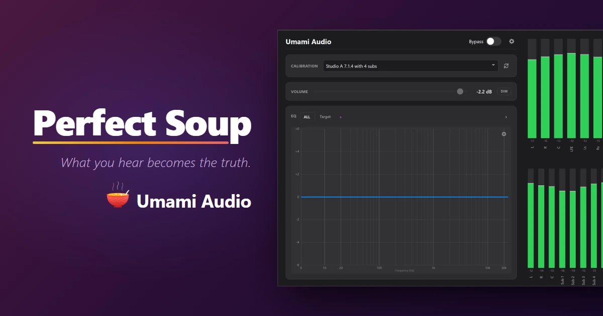

You do not require an active calibration access to create a new target, you can do that right from the VST at any time.
You only need calibration access when you physically change your room or speaker layout or you want to checkout the latest updates to the core optimization algorithm.

Any foreseeable problem with that approach other than the high self-noise? <== no I think it's fine. The self noise DOES affect the calibration though, but as far as frequency response goes, I have two of these ECM mics and they basically line up perfectly with earthworks except below 100 where by 20hz there was like a 2 - 3 dB variation and similarly on the highs, but the entire midrange were within 0.1dB of each other. If you choose to wait, two device support (using a usb mic) is coming soon, although even in that case I would still recommend a umik2 for it's more reliable clock.

I own a Topping DM7 multichannel dac driving a 5.1 setup from a PC and would also love to try out the MIMO tool offered by @umamiaudio - however, I’d vastly prefer to use EQAPO as a host for its global properties and my preliminary research indicated that EQAPO can only host VST2 plugins and not VST3 plugins. Unconfirmed, but Perfect Soup probably falls into the latter category.
Edit: ^ this is seemingly incorrect as of June 2026, as there seems to now exist a fork of EQAPO which has native VST3 support. This is very exciting news for me personally, because one can now run system wide loudness correction or MIMO calibration. I’ll give the software a try soon.
