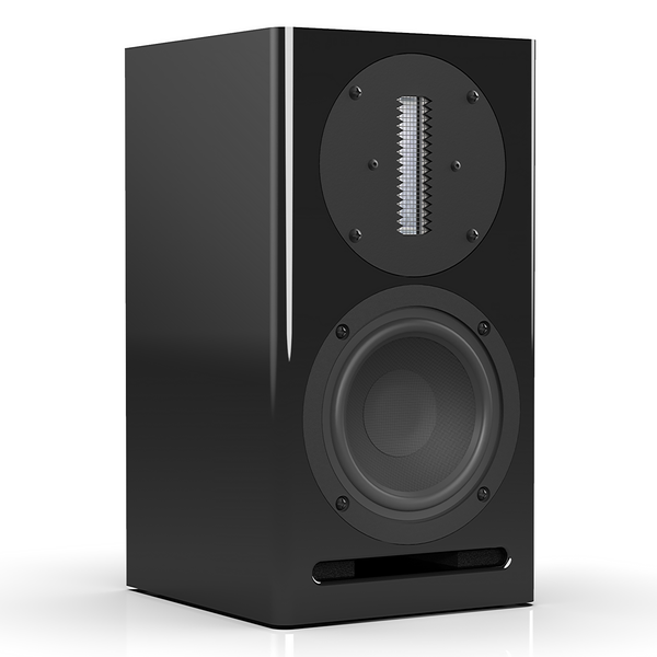

Ascend Acoustics have a few models that would fit, all with measurements.
3-way center:

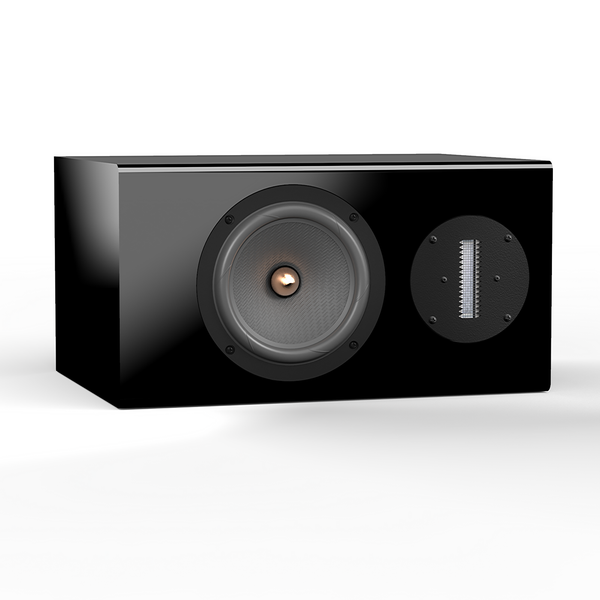

Philharmonic Audio have a similar design as well:
Bookshelf-style center:
The latter two haven even wider directivity thanks to their high aspect ratio tweeter, but they look at bit strange when used as center.
Ascend make a more traditional looking center with that tweeter too, but the MTM design means a strong midrange dip off-axis:
Not recommended.
