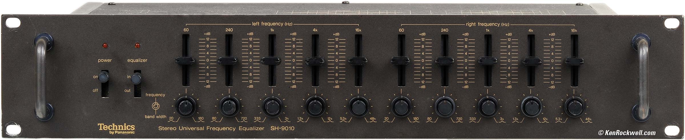

Get an old Pioneer or Technics graphic equalizer if that is what you must have. Or a Behringer to play around with.
