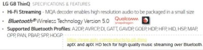

I have attached some Developer Options-BT codec screen shots from my LG G8 ThinQ. Most of the potentially interesting items are grayed-out.
My question: what has to happen to get these grayed-out items, especially anything having to do with LDAC, to come to life and be selectable?
Am I correct that the LG G8 ThinQ has the LDAC codec already on board?
Would a BerryBak BEA1 Bluetooth Receiver connected to the AEGO3 optical digital input bring LDAC capability to the AEGO3?
The BerryBak BEA1 uses BT 5.3. My anticipated use would have the speakers system within 10 feet of the phone, Would BT 5.3 be adequate and BT 6.0 overkill?
Would using a BerryBak BEA1 cause the grayed-out LDAC items on the LG G8 ThinQ to become available?

I have an LG G7 and I believe that in order to see those options you have to be connected to headphones or earbuds that have LDAC capability, and then go into the Bluetooth connection and select LDAC. Are you connected to an LDAC-compatible headphone or earbuds?
Your Bluetooth receiving device has to support LDAC, then you have to connect to the device, and then you have to select LDAC as the Bluetooth codec.
And then you can configure the LDAC Bitrate.
If your speaker doesn't natively support LDAC, then you can add that functionality using a Berrybak BEA1.
Purchased directly from Sure Electronics, it costs about $30 and outputs flawless LDAC audio via Optical.
