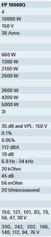

Please note the following table from the official lab.gruppen manual. As you can see 115v connector should be 30A. Meanwhile even with 1/4th rated power pink noise on all channels in 2 ohm, total power draw will exceed 50 Amps! Normally you wouldn't use all channels for bass in such an amplifier (if so, you should use another amp), and often bass peaks are shorter than test signals. Meanwhile european 230V type "B" circuit breakers (used in every modern home, at least here in Germany) can take 3-5x rated current for multiple seconds, allowing 18kVA short term.
Meanwhile THD+N performance seems to be in the ballpark measured with this clone (screenshot from same manual) [Edit: Sorry Table didn't show definition of values}:
