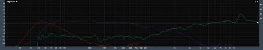

just wonders what is the scales on the measurements are
Sorry I just cut out a bit of the overall REW measurement, so each line is 1 DB - this was the 3DB shelf for the high frequencies. Having played with some Amplifiers with bass and treble tone controls that can vary up to 10DB its odd that Rokit would only allow such small 'presents' - but I guess as a studio monitor in the near field people won't be changing the EQ that dramatically.

That’s quite acceptable FR out of the box then. The drop in hf in your plot seems like the highest octave having directivity issue so rolled off at slight off axis or room reflections I guess. How about horizontal scale? Full 20-20khz?

I actually forgot to post the measurements I made - so here goes.
This test was in my totally untreated kitchen which I know has room modes (and I usually have separate EQ settings beyond the Rokit G4 based ones ) - but I thought it would be interesting for people to see what minor differences the various Rokit 5 G4 EQ settings make. In fairness they only talk about +/- 2db or +/- 3db changes on both the high and low settings. So anyway just to see what effect these EQ settings have I did a bunch of different measurements starting with Neutral and then applying in turn just the Low 1, Low 2, Low 4 and Low 5 (i.e. Low 3 is neutral) and similarly with the various High (treble) settings.
My take away from this test is mostly I think it having some other DSP / EQ is vital (especially for me with the room modes) but the Rokit's exhibit a boosted treble.
Here are the same measurements zoomed in a bit:
