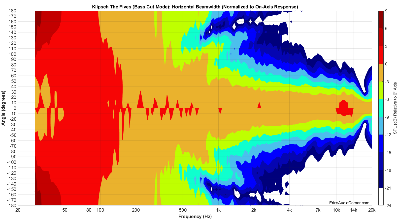

CTA-2034 / SPINORAMA:
“Flat” DSP Mode:
“Bass Cut” DSP Mode:

On-Axis Response Linearity
Response linearity is -2.45/+4.86 dB (80Hz to 16kHz).
“Globe” Plots

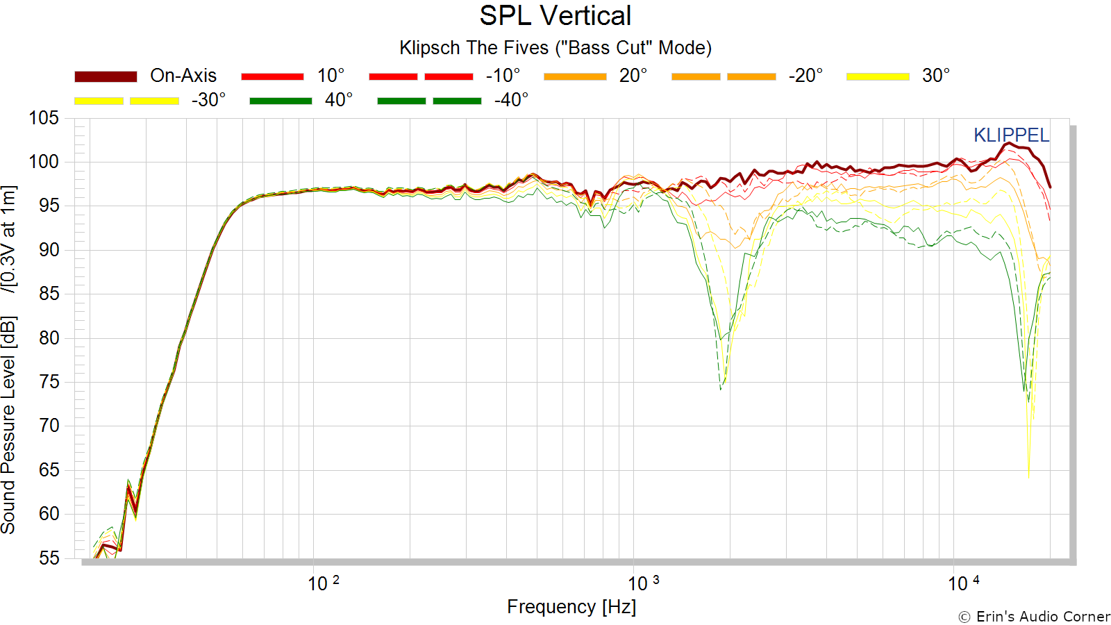

Vertical Polar (Globe) Plot:

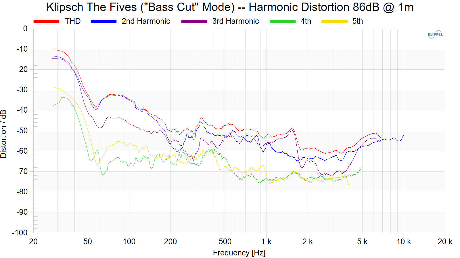

Harmonic Distortion
Klipsch%20The%20Fives%20%28Bass%20Cut%20Mode%29%20--%20Harmonic%20Distortion%2086dB%20%40%201m.png
Klipsch%20The%20Fives%20%28Bass%20Cut%20Mode%29%20--%20Harmonic%20Distortion%2096dB%20%40%201m.png

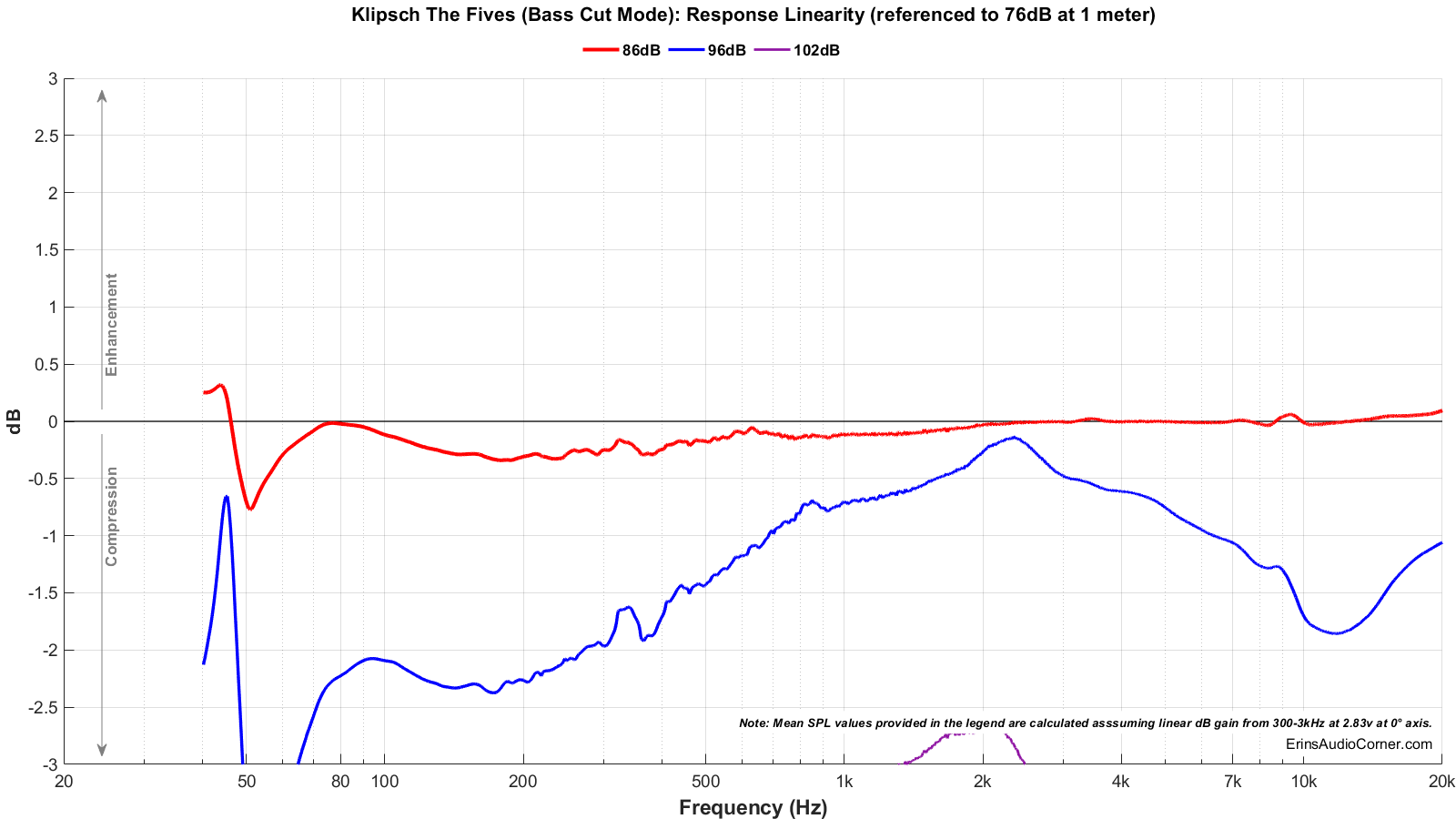

Response Linearity (Compression and Enhancement)
The below graphic indicates just how much SPL is lost (compression) or gained (enhancement; usually due to distortion) when the speaker is played at higher output volumes referenced to 76dB at 1 meter.
Based on my results above, it is obvious the output is quite limited somewhere above the 86dB @ 1m output level. Both the 96dB and the 102dB show significantly lowered output (>3dB loss of expected gain). This is certainly audible when listening, too, as the bass of the speakers dwindled while the highs remained as I increased the system volume. I haven’t confirmed with Klipsch if this is a built-in limiter, though, I assume it is.

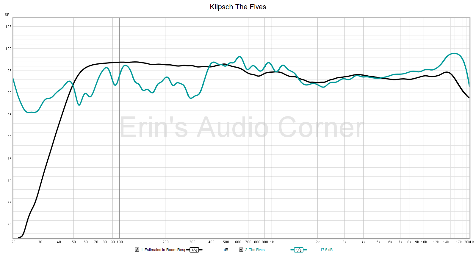

In-Room Measurements from the Listening Position
Below is the actual measured in-room response (with no DSP correction). This is a spatial average taken over approximately 1 cubic foot. The speakers were placed approximately 1.2m from the front wall (not the cabinets; but the actual wall). The listening position was at 4m.
Black = Predicted In-Room Response from SPIN data
Teal = Actual In-Room Measured Response from Main Listening Position at 3.5 meters
As expected, the predicted in-room response and the actual in-room response line up quite well above approximately 500Hz.

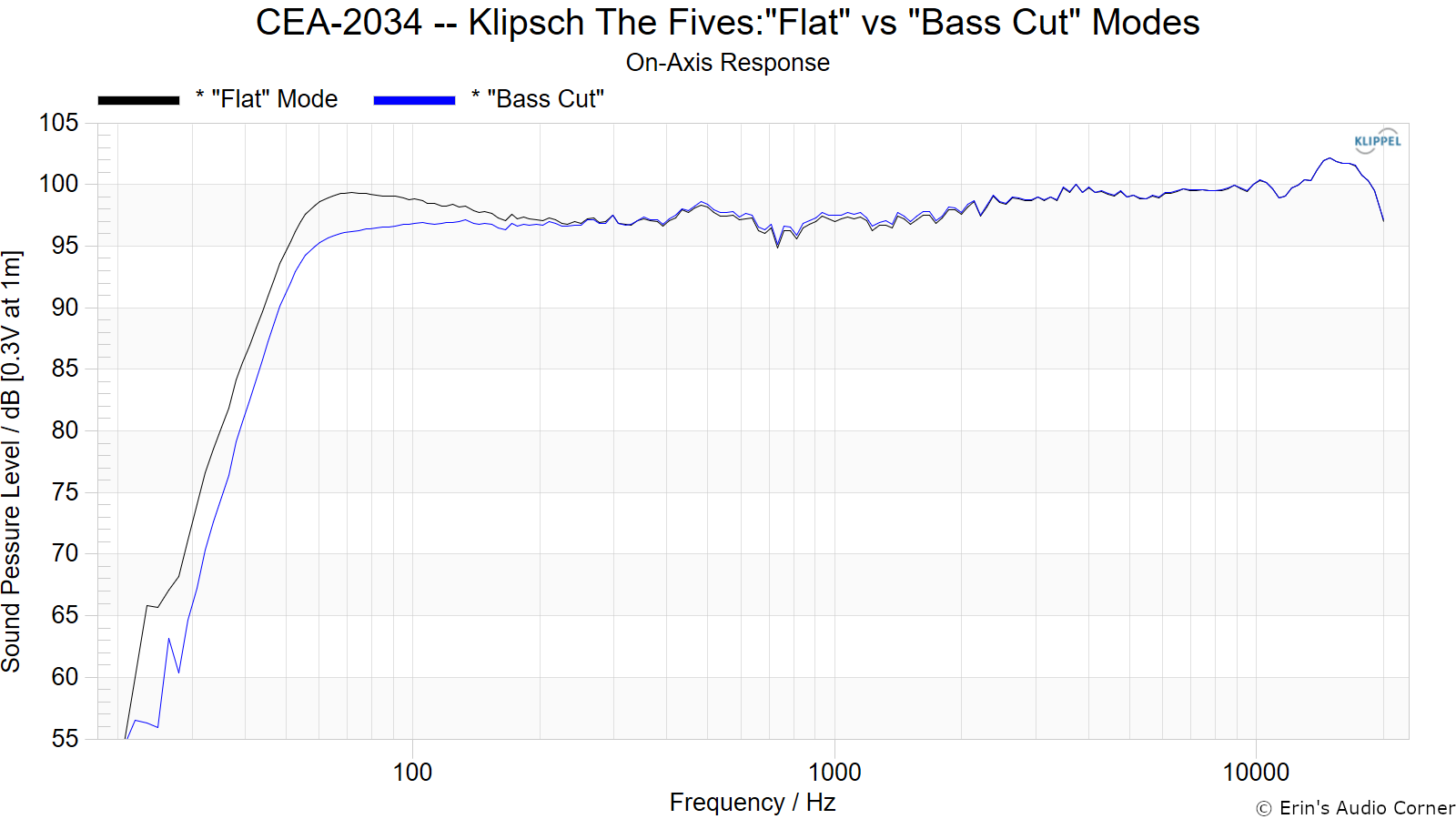

Comparison of “Flat” vs “Bass Cut” DSP Modes
Below is a direct comparison of the on-axis response in the two different modes. As you can see, the “Flat” mode is anything but flat. Ironically, “Bass Cut” mode is flatter.
