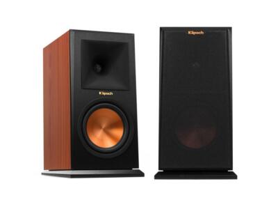

Has anyone seen measurements for the rp-160m. (The previous itineration of these)
I am wondering if there is much if any difference. The 160's can be had for $250 right now new. The directivity and post PEQ Harman score of the 600' here is quite good so if the 160's match that could be good for some buyers.
I’m fairly certain it’s the exact same speaker. Exact same crossover components as my 600 M crossover says 160 as well
Wow, same crossover board.
I had feeling they were basically the same though the tweeter has ferrofluid now which may or may not matter at all. Hmmm, well if anyone wants the 160m and doesn't already know, in the USA the RP-160m is on sale in Cherry @ newegg for $249.99 (also sold on eBay by newegg for the same price)

From what I can find the main advertised difference between the RP-160 and RP-600 is that the RP-600 has a vented tweeter whereas the RP-160 tweeter is unvented:
VENTED TWEETER DESIGN
The new vented tweeter housing reduces standing waves that create unwanted harmonics, resulting in enhanced detail and clarity in high frequency reproduction.
