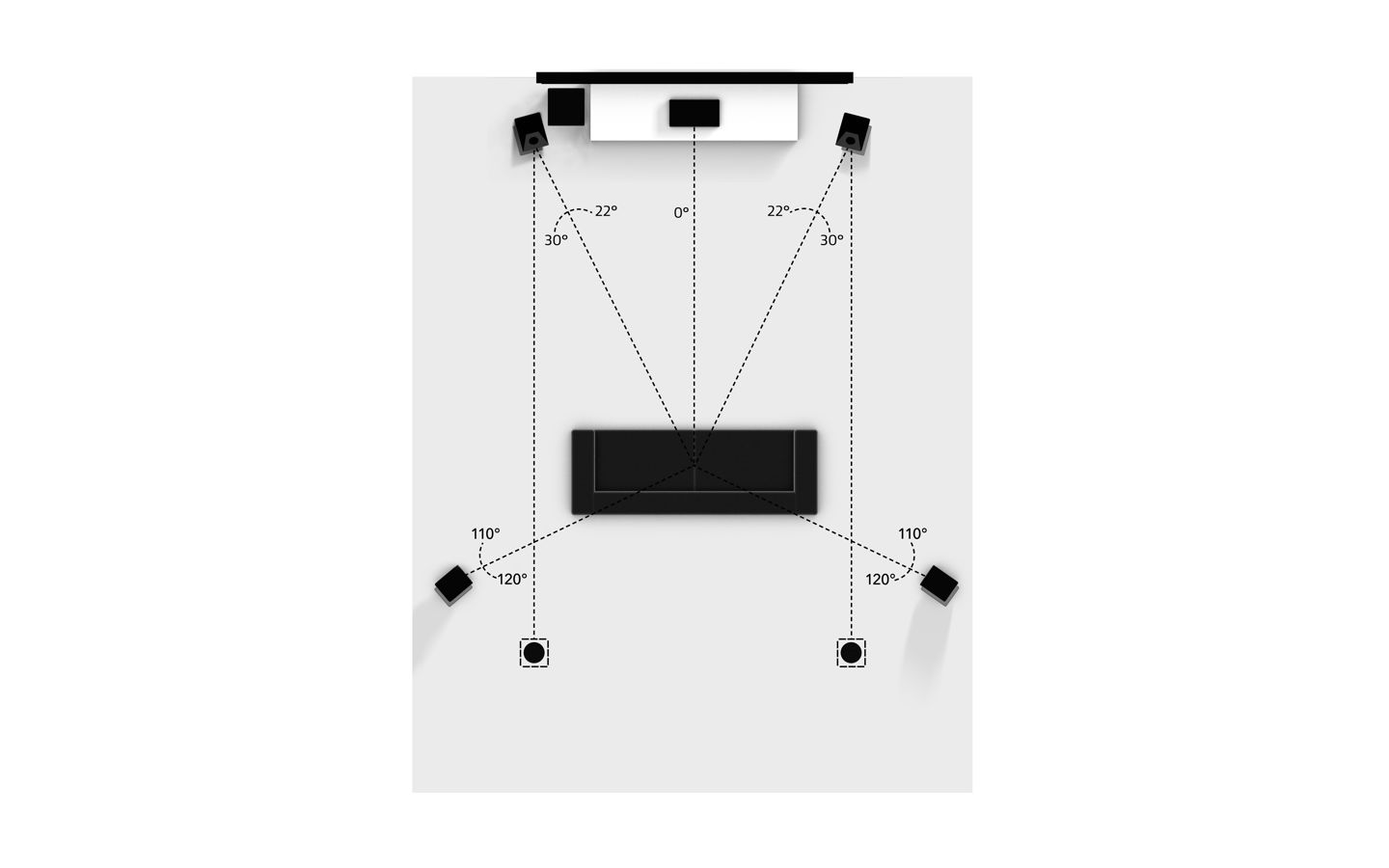

For speaker placement, I don't know what your options are, but I would say just try your best to follow Dolby's recommendations.
From what I can see, you should be able to place your surround speakers symmetrically if you move them and the couch forward for about 1.5 to 2 meters, but again I am not really sure.
