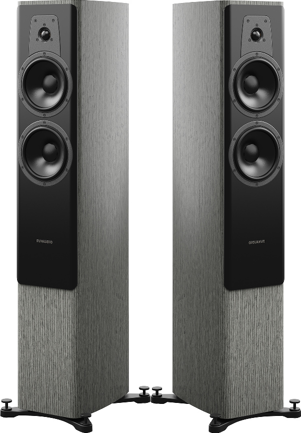

Contour i are phasing out to make room for new Contours... there are 50% discounts going on, so I strongly recommend that you try Contour 30i.... here's the review:

I have Dynaudio Contour 30i speakers. I tried the bottom and top plugs (half and whole) in all combinations (top, bottom, top & bottom) and decided not to use them. The speakers are positioned 50 cm away from the back wall and around 1 m away from the side walls. The plugs will greatly influence the sound. So, if you decide to use the plugs, run the optimisation software again.
