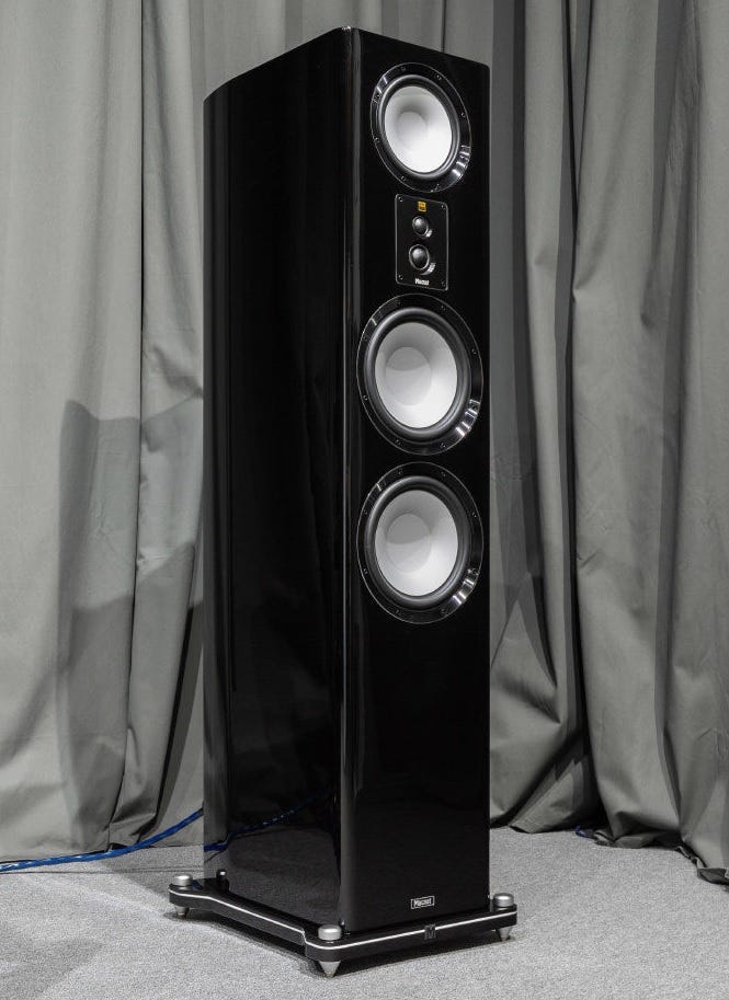

An interesting speaker.
I've been thinking about buying a high-end speaker for a long time.
There is only one “problem” for me: I am still absolutely satisfied with my Magnat Signature 707.
But my brain screams for more...
