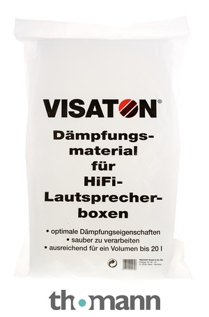

Beeing aware of Hifi Alex Q350 pimp since long, comments here convinced me to try it by my own.
What should I say, without having any measurements I believe that the speakers sound after damping more neutral, more precise. Even my wife - which is not interested on technical at all - said she can "see" now the instruments...
As its an easy to do, cheap and completly reversible pimp I say every Q350 owner should try it by himself. If he's not satiesfied he can switch back.
I added one of these to every box
BTW. for removing the trim ring I used a tire-"iron" made out of plastic like this one.

You are right, measuring would be better. And yes I'm aware of bias (newer, higher price, more beautiful, own work ...), had this experence several times in my life ...
On the other hand. You can't verify everything by your own. E.g. a lot of people here trust Amir and his measurements, I decided to trust the measurements of Hifi-Alex AND the descriptions of people who have added damping to the Q350 enclosure. I wasn't disappointed. So my thanks go to them.
If I could see further usage of the UMIK1 I would consider of buying such, but in the moment I have nothing in mind. nevertheless thanks for the suggestion.
Sonofil is a trademark for damping mats. Naturally you can use others.
The filling should be sufficient for ~ 20ltr.
Here's the link for original sonofil
