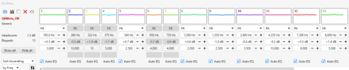

Alright so I received 3 Q6 to use as LCR but still waiting on some stuff to mount the center above the TV but I've been listening in stereo all weekend and they work great as mains so far. My biggest gripe going to 3 ways in the past is I was losing a bit of the point source sound but the MTM layout seems to create an apparent point source better than the R3 I was using a few years back, I'm sure that is why the R and Ref series use this driver configuration. Anyway, comparing these back and forth with my original LS50 it's clear the midrange is much smoother on the Q6, I EQ the LS50 to tame the highs but they still seemed a bit more forward than the Q6. The bass is really good as well, I was worried that being sealed they may roll off too soon in room but they handle an 80Hz high pass fine and have much more mid bass so sub integration is a lot easier than with the LS50.
