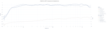

How would the Concerto compare to the R3s (non meta)?
Assuming both are about the same price.
I'd highly suggest you to check it by yourself.
FR graphs are good thing to check overall balance and so, but real experience will give you more. Actually, you can see traces of that "more" on FR graph: R3 has a lot smoother graph. It has better cabinet, die cast drivers chassis, better crossover components and so on.
That said, applying a ruler to FR graph or PIR or whatever can lead you to funny situation when you make the "smart choice" and grab a cheaper but more praised pair of speakers and then once hear a "flawed" but higher level product. There's a big chance that you'll feel yourself fooled at that moment.
Many years ago when KEF low range lineup was iQ and the next range was XQ, the latter was on a whole different level. Like night and day difference.
So check both Q Con and R3 before buying :)
