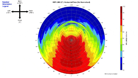

And let's go further, let's compare the directivity directly;
Now, I'm not implying this demonstrates that the cheapest good speaker I've seen will equal the sound quality of LS60. But I'm saying that we as a community should be careful to exclaim that good tonality, design and user-friendliness alone is enough to shout hallelujah from the rooftops.
I am not impressed by a 7k active floor-standing speaker that will be outperformed in dynamic capabilities by almost any small shoebox speaker at any price. And frankly, I'm surprised so many are.
