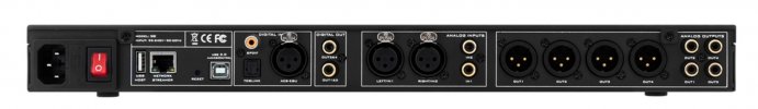

The miniDSP SHD is a great unit, but I would not use it for these speakers. You don't need the analog output. (You would be paying for DACs you don't need).
I would save some money and use a WiiM Pro and a miniDSP Flex with digital outputs. It has both optical and coax digital outputs. The main LS60 speaker also has both an optical and coax digital input. Just make sure that you get a sub that has a digital input in the form of optical and/or coax, and you are set.
Another option is the SHD Studio, which is all digital, and includes a streamer. So, you wouldn't need the WiiM.
Also, the SHD includes a streamer, so you wouldn't need the WiiM with that either.

A miniDSP SHD unit is also provided with digital output.
I know. I owned one.
My point is that the SHD costs $1,299.
The SHD Studio costs $949 and includes everything that the SHD includes, except for the analog outputs, which are not needed for the LS60s.
The miniDSP Flex, with the Drac Live option, costs $649. A WiiM Pro is $149. So the total for this option is $798.
So, since he doesn't need the DACs for LS60s, why spend the extra money?

I had the SHD - I used the analog outputs. It is a fantastic unit.
I just recently sold it and replaced it with a miniDSP Flex HTx. I need 8 output channels for a project I am working on - https://www.audiosciencereview.com/...-fi-reference-ubr62-bookshelf-speakers.51780/
Using a Flex or Studio with the LS60s would give you far, far more tuning capabilities, which you were concerned about. But, you end up needing to run a cable to the main LS60 in order to do so.

One more thing. With the SHD, I think you only can use Dirac Live on the analog outputs or the digital outputs, but you can't do both (e.g, use two channels analog and two channels digital). I think it has something to do with the 2-channel Dirac Live license that comes with the SHD. If you might want to use both analog and digital outputs simultaneously, you may want to check with miniDSP to see if you can find a work around for that, for example by upgrading the license.
