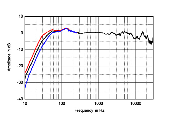

3.1 Uncorrected Response (Blue Curve)​
The blue curve (Figure 1) reveals substantial peaks near 24 Hz and 60 Hz, along with additional irregularities between 100 and 200 Hz. Subjectively, these peaks produce a “boomy” or “heavy” bass characteristic. The 60 Hz peak is particularly problematic, causing bass overhang and masking details in the upper bass region.
3.2 REW MMM Correction (Green Curve)​
The green curve (Figure 2) demonstrates a significantly more even response below 300 Hz once corrections are applied. By attenuating the 24 Hz, 60 Hz and around 100 to 200 hz peaks, the overall bass character improves. Subjective listening confirmed a reduction in boominess and an increased sense of clarity, allowing the KEF LS60’s inherent qualities to come through.
3.3 Wiim Room Correction (Purple Curve)​
The purple curve (Figure 3) shows the outcome of Wiim Ultra’s auto-correction feature. Contrary to expectation, the system boosted frequencies between 20 and 70 Hz rather than attenuating them, exacerbating the existing room modes. It also introduced noticeable changes around 1 kHz and a high-frequency lift of approximately +4 dB. Subjectively, this yielded an overly bass-heavy and excessively bright tonality, diverging considerably from standard room correction targets. It appears that Wiim’s current algorithm attempts a full-range correction but may lack sufficient resolution or measurement precision to accurately handle complex room interactions.
