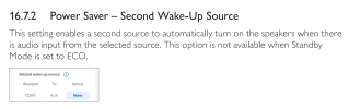

Additionally, does the LS60 have an "Auto sense" feature for coaxial input?
You can make it so that the LS60 will wake up from standby as soon as you send audio to its Coax input:
Whether, when turned on, the LS60 will auto switch between inputs, I don't know.
The Ultra will, FWIW.
I have my LS60 AutoSense set for Coax and it is switches on/off maintaining Coax as source. It is the only source I generally use but manual switching works, too.
