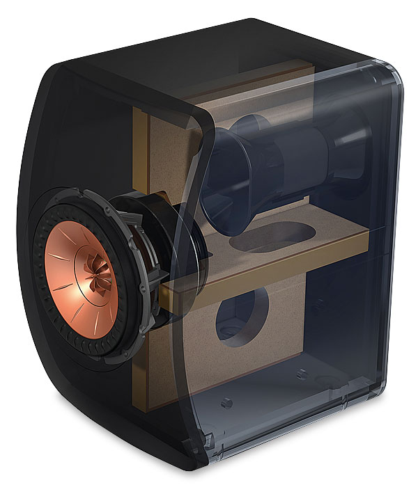

This is a review and detailed measurements of the KEF LS50 Meta bookshelf coaxial speaker. It was kindly purchased new by a member and drop shipped to me and costs US $1,500 for a pair.
The LS50 Meta comes in different colors and I must say, it looks stunning in white:
You could sell it as a decoration piece and it would still sell strongly!
Even the back panel oozes beauty and custom design:
Love the wide apart binding posts that are easy to tighten and loosen.
Speaker also feels quite dense and solid which is good.
