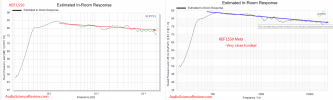

And if you don't believe my comparison in my own room, check the measurements of either in this very web site, side by side. Oddly one is recommended "very close to ideal", the other -with identical behavior- not, which is bizarre, but hey - what I love about this website is it allows us to make up our own mind and reject the subjective and see the measurements. Both are stellar speakers - and their in-room response {as well as pretty much every measurement) is damn-near-effing identical. If anything the original looks a tad more linear there. And yes, there are other aspects to consider. But let's be honest - anyone that claims to hear a clear difference...
You just need to bother spending the time going to Spinorama github, open up a tab for meta and one for ls50 and tab back and forth.
Meta is flatter here in that the dips and peaks are less but also the overall slope of the curve is closer to 0 vs LS50 which is going upwards.
LW is closer to on axis. Early reflections DI and even more so sound power DI is smoother with Meta. It is going up and down on Ls50.
Look at how much LS50 goes up past 4khz before coming back down. 1khz is more crushed too. Better directivity allows better EQing. This alone ends the debate.

These measurements are too different for you to start saying people who hear a difference are just suffering from placebo. Trained listeners can hear distortions many, many, many db below the average person. There are even tracks designed to tease out differences in tonality. If you think that peak of LS50 at 4-5khz is too high Q to be audible, then look at the dip on the LS50 from 400-600hz with a difference of 2db between the two.
You might not hear a difference and that doesn't mean your ears are broken. That's a perfectly reasonable statement to make. But you didn't want to stop there. All this time writing white papers and you don't know you're not supposed to compare two curves with different axises.
Look at how much LS50 goes up past 4khz before coming back down. 1khz is more crushed too. Better directivity allows better EQing. The above to sets of curves are most definitely NOT THE SAME at all. This entire debate is over, this is the killshot.

These measurements are too different for you to start saying people who hear a difference are just suffering from placebo. Trained listeners can hear distortions many, many, many db below the average person. If you think that peak of LS50 at 4-5khz is too high Q to be audible, then look at the dip on the LS50 from 400-600hz with a difference of 2db between the two.
You might not hear a difference and that doesn't mean your ears are broken, but if you're willing to bet money nobody else can hear a difference you're going way too far. All this time writing white papers and you don't know you're not supposed to compare two curves with different axises.

Nope, all sources that have measured both confirm those on-axis, directivity and distortion differences, here for example Soundstage
and my own measurements (I own both)
