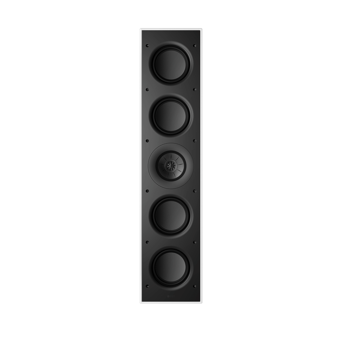

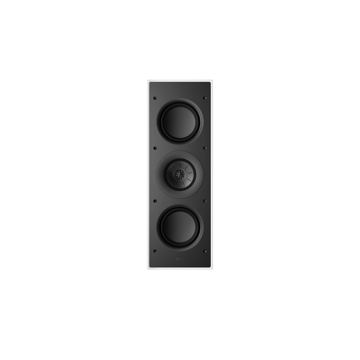

2 new THX models
The pricing seems a little goofy. At least in Canada, the Ci5120QLM-THX is currently 2x the price of the Q11 Meta.
Ci5160RLM-THX are the same price as the R11 Meta.
Ci5160REFM-THX are the same price as the Reference 5 Meta.
Ci5120RLM-THX are the same price as the R11 Meta.
Ci5120QLM-THX looks basically equivalent to the R11 Meta, but at least here in the US it's about half the price.
Ci3120QLM-THX looks basically equivalent to the R6 Meta, but is about $900 cheaper.
These new in-wall models are Q Series, not R Series. Also strange that you edited what I wrote.
