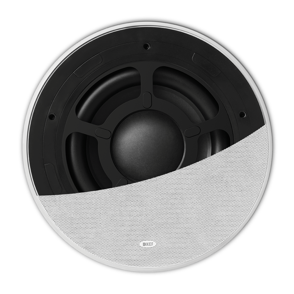

I think I also saw an in-wall KEF subwoofer released recently
KEF already had a few in-wall subwoofers:
But, yes, there is a new one as a companion to this speaker, in the same 300mm mounting size (with a 10" driver):
