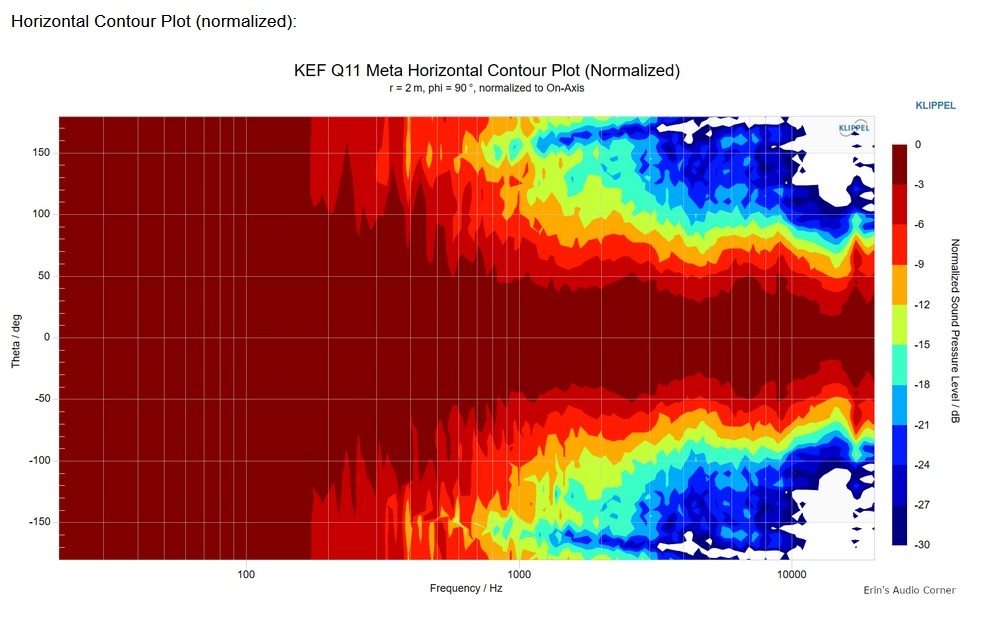

Those woofers are crossed over at 350Hz (on the Blade One). Let's check the contour plots:
Looks omnidirectional well past 350Hz. I don't think the KEF engineers implemented a flawed concept.
@kyuu I agree that the vertical directivity is fine.
But the horizontal directivity seems very narrow above 350 Hz compared to a Kef Q11 Meta.
It is obvious below 1 kHz.
That's intentional and desirable, you get less room interaction. Other designs take the point even lower, how low is ideal is debatable.
It's not as narrow as it seems due to the different presentation of the contour plot. Here's the Blade Two Meta:
Just about exactly the same to my eye, except for being better controlled than the Q11.
