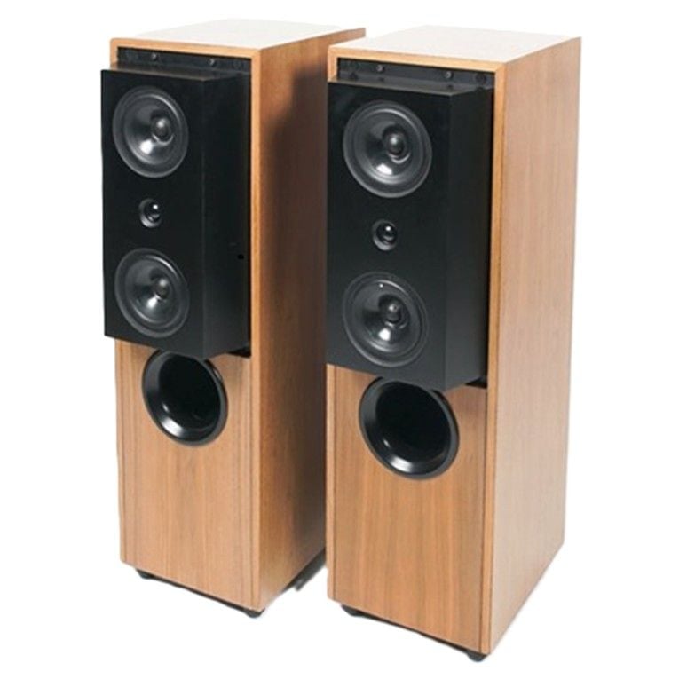

I got a pair of good condition KEF Reference 104/2 from e*ay for 280GBP, and paid another 100GBP to have them couriered to me.
While playable, they were untouched from new, (May 1986) so needed to be fully restored. Which I completed at 230am this morning, totalling 20 or so hours work over 4 days or so. I built on the previous experiences I've documented here, and with other speakers I've not mentioned. Possibly 10-15 pairs in total over several years, usually listened to for a while then flipped for cost.
KEF 104/2 – Formal Service Record
This document records the full refurbishment and restoration of the KEF Reference 104/2 loudspeakers, carried out to a standard meeting or exceeding professional practice in mechanical and electrical service for vintage loudspeakers. All work was completed with suitable, application-specific materials and methods, restoring original performance and ensuring long-term reliability.Work Summary
