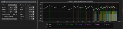

I realize this thread is dead but I finally found the rew measurement of my room untreated. I have a pair of KH120ii right now and I really like these compared to the Dynaudio. The Dynaudio BM5a actually sounds scooped in the mids. I had to turn down the HF and LF dip switches in the back after listening to the KH120ii. Attached is the MA1 calibration. I'm still not sure if I am going to get a sub or keep the KH120ii but I am definitely moving things around in my room after running the rew simulator. Attached are the room simulator images of what the new setup would look like.

Sorry, this is without the sub
