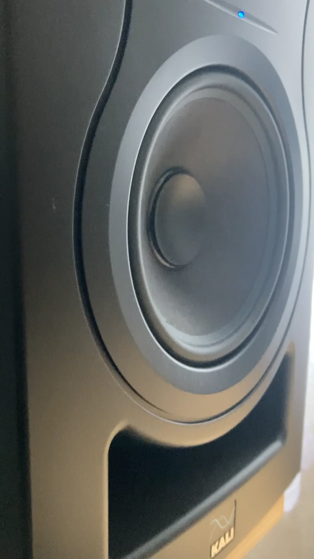

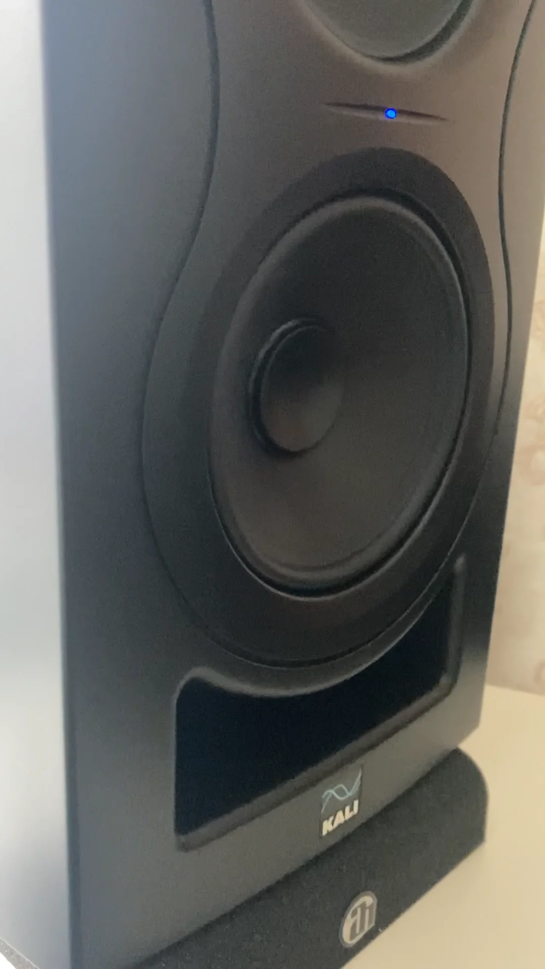

I returned two monitors under warranty, but still the problem was not fixed!!! Tree different monitors and still the same problem..... Right side monitor was better but still not perfect and resonates at higher volume.
I'm not in your room. I don't hear what you hear, especially not through an unsteady phone. Do you have a measuring microphone?
Did you try to dampen vibrations with something under the speaker? Did you check that nothing on your desk or elsewhere is causing the vibration?
Edit: Did you try listening to the speakers in a different room or on a different surface? Did you make sure that it wasn't the stand vibrating? Did you try switching left and right speaker positions?
No i do not have but i have very good hearing i can hear hiss noise from 1-2m away in bad monitors like JBL 305P or Focal Alpha EVO 65.
I did try to dampen the vibrations but end result was pretty much the same there are wide amount of songs that KALI audio IN-5 will not handle because of poor build quality and materials.
Another example this time more faulty monitor is in right side.
