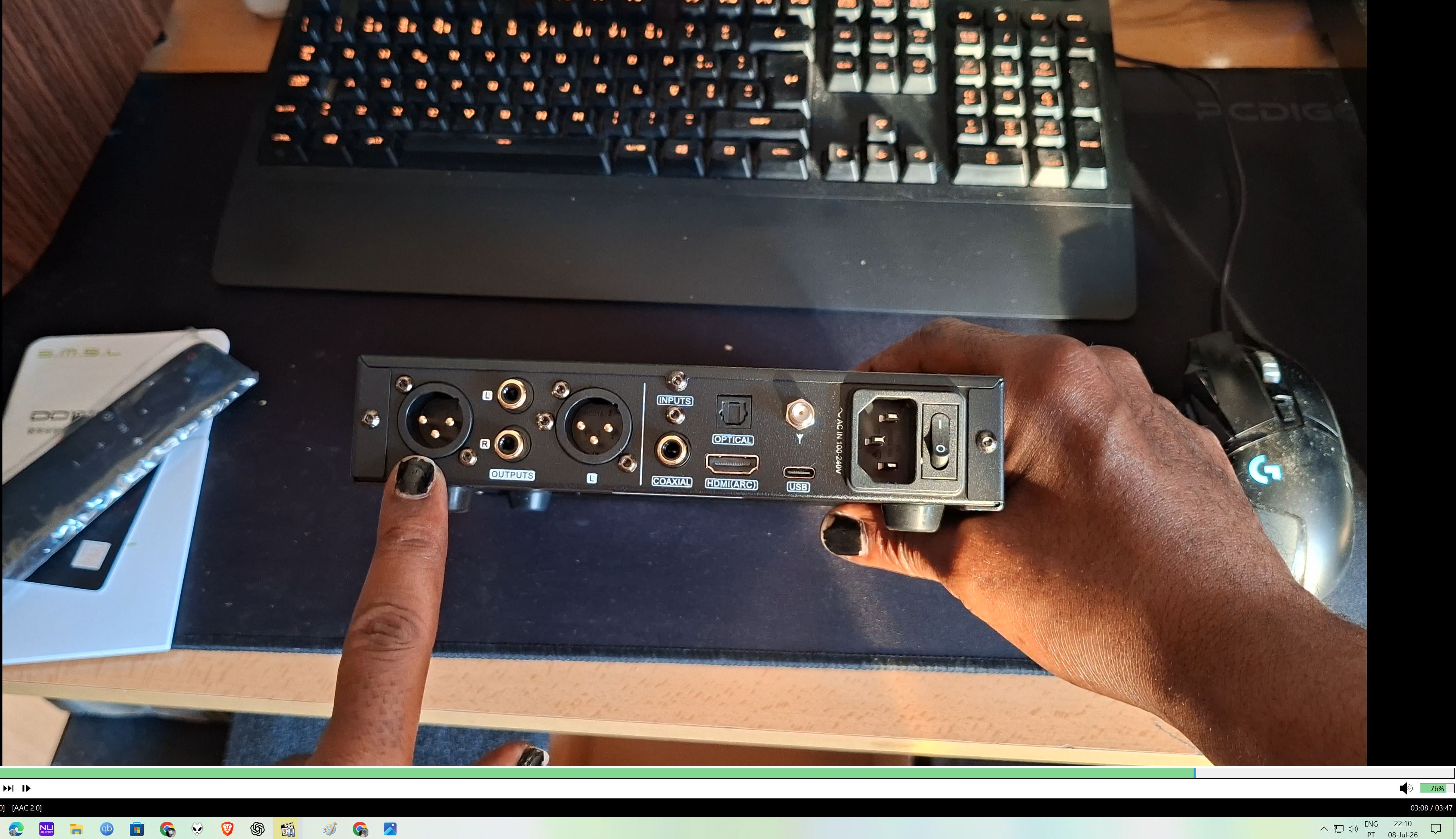

Nope, playing around with DACs is not going to help you.I just ordered SMSL DO100 Pro, do you guys think this is going to improve my audio quality besides reducing noise?
