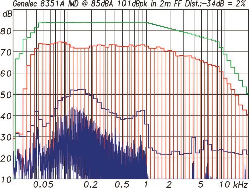

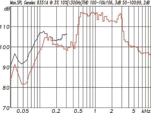

Another 3 ways option: http://ksaudio.com/ks-digital/c88/c88.html
Another cheap 2 ways: https://www.fluidaudio.com/products/fader-series/fx8.html
and most of the Geithain (https://www.me-geithain.de/en/aktiv-lautsprecher.html) but they are very expensive.
1570958383813.png1570958533928.png1570958956963.png1570958969536.png1570958985153.png
Didn't know much about KS, looks nice, but SAR measurements of their A300 flagship (https://www.soundandrecording.de/eq...tudiomonitor-mit-firtec-equalization-im-test/) are disappointing, to say the least; especially when they're 2500€ per unit.
Always found Geithain intriguing, but I can find them in any internet store and can't find third-party measurements. They give the important ones, at least, but the SPL/frequency at fixed THD level and cumulative spectral decay are missing.
