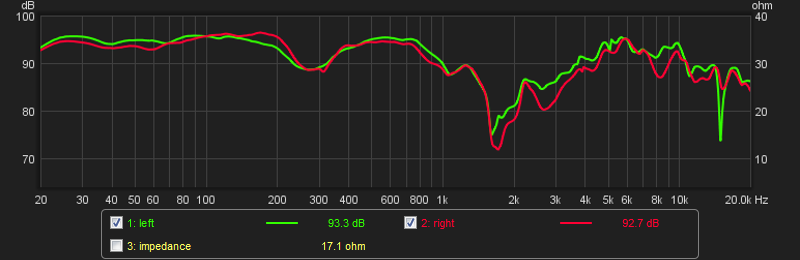

These headphones have 2 drivers in it. One 55 mm for bass and a 30mm for mids and highs.
Below a plot measured by ultrabike (Changstar) with a flatbed DIY rig.

I agree and while it definitively isn't a well tuned headphone, the fixed frequency based choice of the reference curve makes it look worse than it is, below I redraw it manually quick and dirty at a difference level and there you can see it mainly needs 2 PEQ with approximately -7 dB for the two upper bass / lower mid bumps and possibly smaller one for its "Beyer" bump between 7-10 kHz (would experiment if filling partially the narrow-ish dip between 1-2 kHz is worth it):
That looked a lot better than I initially thought it was. It certainly has a lot of room to improve here.
