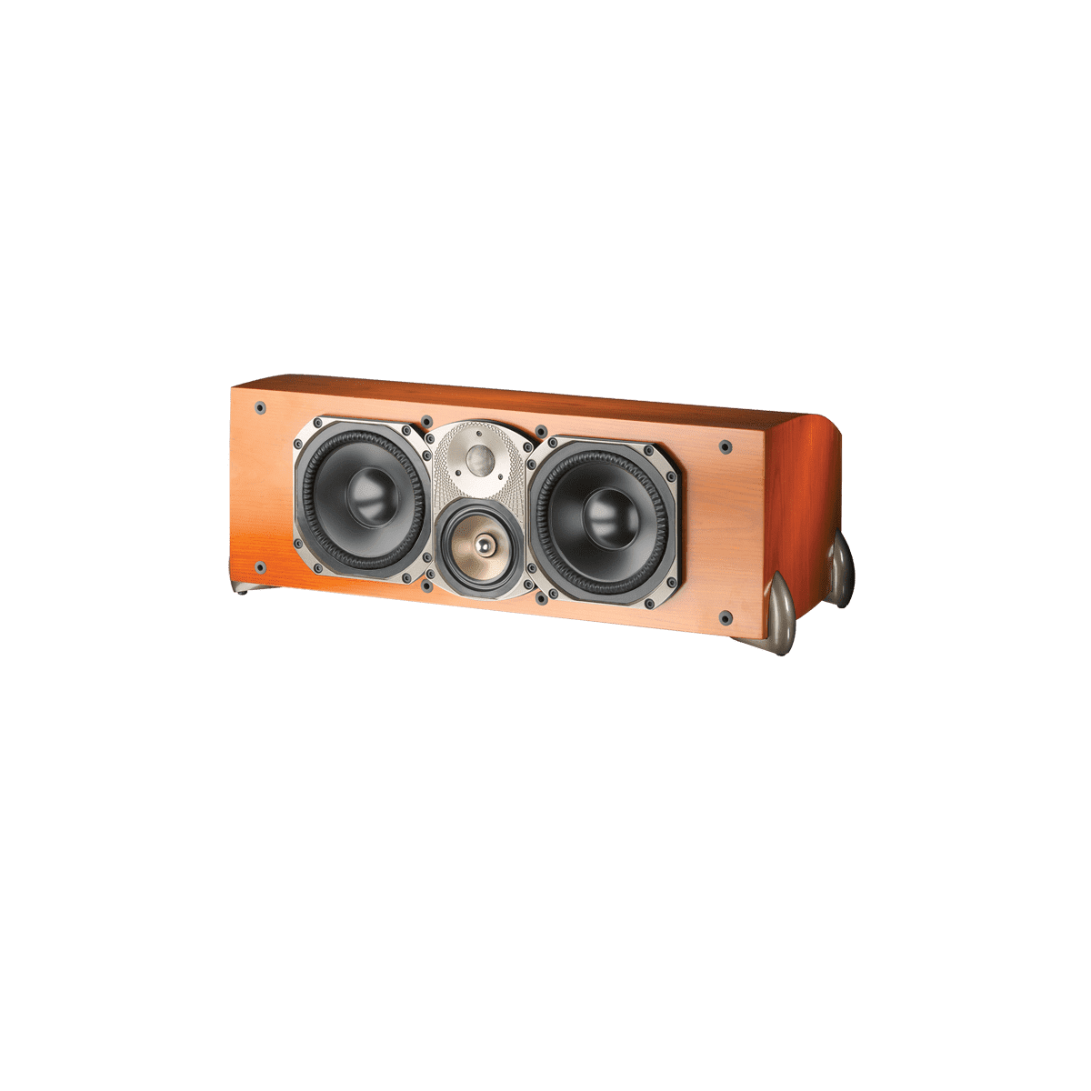

This is what I use, it's certainly not a current model, but I've been very satisfied with its performance. Size = 9.5"x26.5"x13" and weight = 45 lbs. The horizontal dispersion seems good as my wife sits to the side and even with her hearing issues ( since remedied with excellent aids) it has worked well. But its price was well above the tested. It replaced a Focal Chorus which was in the MTM configuration. That speaker was not adequate for our great room as its horizontal dispersion was seriously lacking. It now resides in our MBR and works well there.
