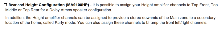

- I then tried zone 2 line outs to the 2nd room, but am getting nothing, so assume zone 2 line out only works for non HDMI inputs, but there is zero mention of the zone 2 pre out in the manual...
It's definitely mentioned in the manual:
It says it provides a stereo downmix of whatever the source is, though it doesn't clarify if that applies to digital inputs like HDMI. I haven't used that functionality at all myself.

I'm not really understanding what you're saying here. You have two outputs connected to the AVR? Two different TVs or what? ARC is used to pass sound from what's connected to the output (usually your TV) to the AVR.
I could be wrong but I assumed that the "party" functionality is referring to the speaker assign zone 2 output option (mine are all used for a 5.1.4) and not the line out zone 2 I was trying to use to a wall mounted soundbar in another room. Will have a play to see if I can get it to work that way
To clarify on the first point yes was trying to play output to 2 TV's. So have a CCWGTV as input, with picture on main lounge TV where the MA9100 is, plus to another TV in the kitchen. Picture displays on both, audio via the MA9100 in the lounge, but no sound on the 2nd TV (unless i set audio to output to TV which works but means switches off audio from the AVR to the main TV. I tried both PCM and bitstream audio settings on the 2nd TV but got no sound, so I don't think the 2nd HDMI out carries and audio normally, so about as much use a chocolate teapot as the saying goes
I could be wrong but I assumed that is referring to the speaker zone 2 output option (mine are all used for a 5.1.4) and not the line out zone 2 I was trying to use
The part I posted is definitely referring to the line out. The part that refers to reassigning a pair of amps is here:
This is from page 24 of the manual linked here: https://www.jbl.com/on/demandware.s.../pdfs/MA7100HPMA9100HPOwnersManualENWEBv2.pdf
The part for the Zone 2 line out is on page 25.
Thanks so much - user error from me ! Had to enable party on line out, then I can switch it on in the main menu.
